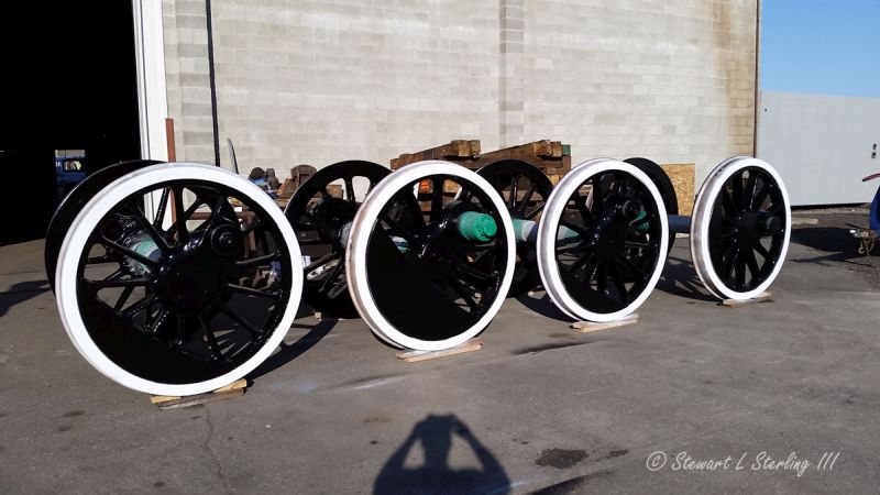

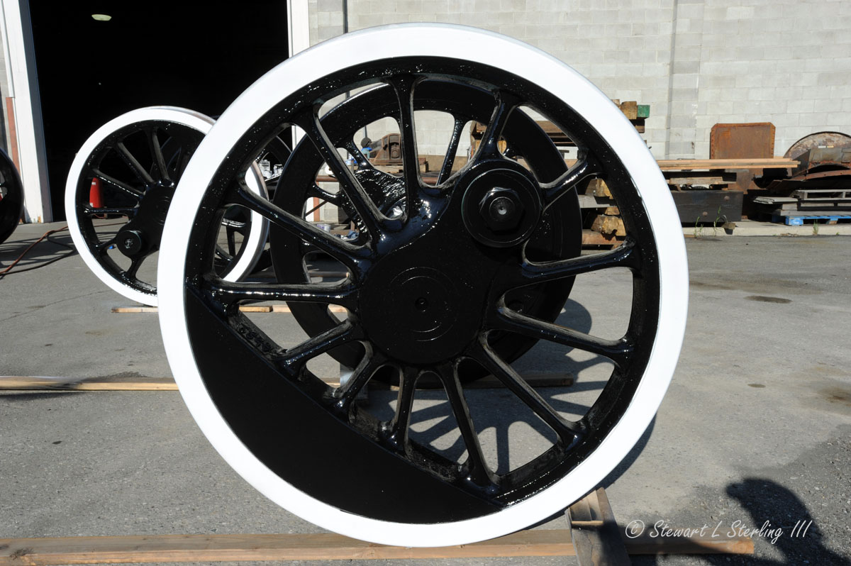

Now sporting a new coat of paint, the drivers are done! Over a dozen volunteers removed many layers of old paint and grease, smoothed casting flash on the spokes, did a detailed inspection for cracks, and applied a couple of coats of primer. Machine work was contracted to Tennessee Valley Railroad where tires were turned and all bearing surfaces were cleaned up and burnished. Their discovery and correction of a couple of problems may put the drivers in the best shape they have been in since USATC 3523 rolled out of Baldwin's factory 70 years ago.

Posts: 21
These represent a long hard saturady. Hot too for alaska, it was 75*.

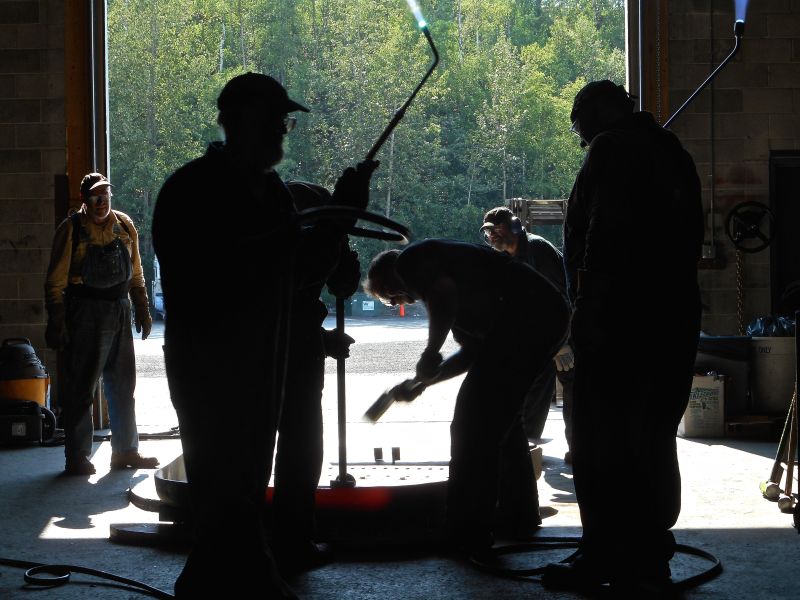

Gary and Robert from Steam Services of America and 557 volunteers Jeff, Ron, Jerry, and Terry make some fine adjustments to the new door sheet as part of the process of getting it fitted and installed.
