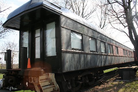

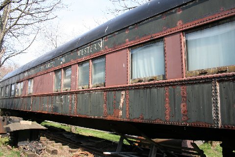

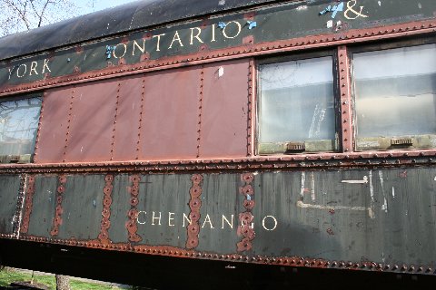

Rainer Rails ( and others )
In regards to the car mentioned as the NYSW Chenango, I believe this car is the "Herald Square" and is owned by a gentleman who I believe lives on the car in Ringoes NJ on the BR&W. This car perhaps might hold the record for the longest restoration to Amtrak service, as I know this project continues on now for likely over 20 plus years...( a true testament to his desire to run ...)
The car has had an open platform added to one end and the interior has been significantly altered from its 6C-3DR configuration... ( car was not built with open platform shown )
Last I heard the owner was having a set of OSH trucks rebuilt...
Here are a few photographs that I took of the car perhaps a year or two ago...
Thought you might find this of interest
Dean Levin

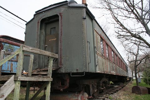

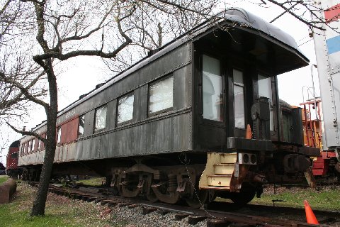

a few more photographs
Dean Levin

I hate saying it but I do not believe that the NYO&W Chenango car shown in the images posted by Dean is the same car that previously had been lettered NYO&W Chenango... the car in Dean's shots is a business car that I do not believe was rebuilt from a 6 Comparment - 3 Drawing Room car shown in the images linked to below, there are just too many consistence:
http://rr-fallenflags.org/nyow/nyow-cheo-akg.jpg
http://rr-fallenflags.org/nyow/nyow-cheo-bkg.jpg
It would take a considerable amount of work to rebuilt a sleeper car into a riveted side business or private car and even with a long target date... the work involved would take a good size shop force to accomplish it, not just a couple of people. And considering that the side sheets on the private car look original I doubt that the owner took the car completely apart and then proceeded to reapply new side sheeting to match the business car configuration.
While I have no idea what the history of the business car is (have gone through what links I have on a non-rebuilt, non-modernized, business cars and have not come up with a possible history, I suspect that there is yet an answer out there as to what the car use to be. As for the Old & Weary lettering and Chenango name on both cars both were likely applied by the owner for sentimental reasons and it may be that the owner of the business car formerly owned the 6-3 sleeper, which could help to explain the use of the names on both.
I still have more pages to check, along with a few other references. Hopefully the real history to the private car can be found. Better still, hopefully both the private car's history and the history for the 6-3 car can be found so that both can be properly accounted for. (Chenango was the name of one of the counties that the O&W ran through.)
jerry

It's the same car. The owner has done some serious alteration to it, keeping to Pullman practices- remember that Pullman would do major reconfiguration to cars that totally changed them. I was inside this car in 1970, and he'd already been working on it for a couple of years. 40-plus years of restoration, not 20!
