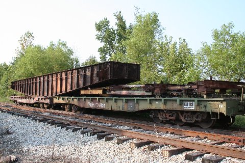

looked on line with no luck... this turntable at KRM... anyone know where it was originally located ?
thanks
Dean Levin

 Post subject: Re: Turntable Thanks & Questions
PostPosted: Mon Nov 28, 2011 12:52 am
Joined: Fri Aug 06, 2010 9:57 pm
Posts: 109
The table at Kentucky Railway Museum is from the NYC/Big Four Louisville roundhouse. For more turntable info, see Ron Goldfeder's article in the Fall 2010 RMQ/Trainline.
Aaron Isaacs, editor
