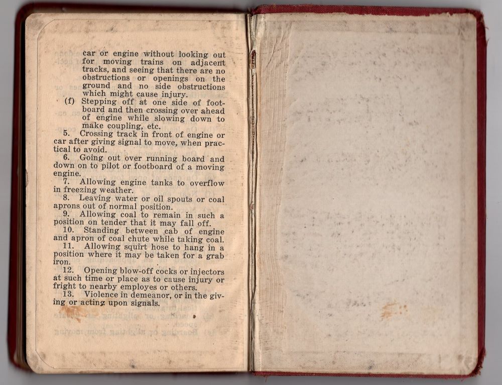

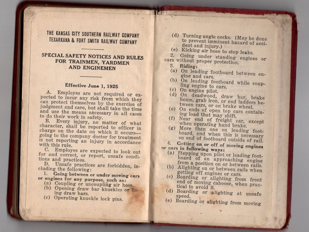

In the vein of this discussion, I present these 1925 supplemental rules I found pasted inside the back of a well used 1923 Kansas City Southern Operating Department rule book.
Jason Midyette
