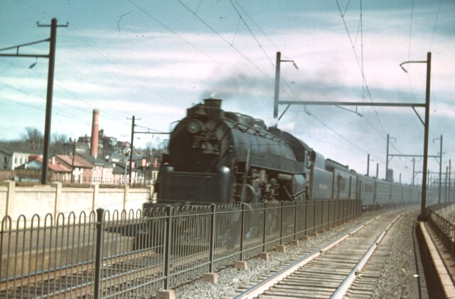

At the risk of drifting even further from the OP's question....
If you're talking trolley lines. almost all steam RR's ran under wire - at grade crossings.
And some railroads ran steam underneath both their own electrification and a trolley line at the same grade crossing. For something less than a decade in the 1930s, the Reading's 11 kV catenary intersected with Philadelphia Rapid Transit trolley route 55 at the York Road crossing in Willow Grove. As it was explained to me, the RDG's MU cars had to coast their pantographs through the crossing. The streetcar's conductor, who had to flag the crossing anyway, had to throw an electrical switch to energize the 600-volt trolley wire and then throw it back once the trolley had crossed the tracks. RDG steam locomotives running up to New Hope passed beneath all of this.
The PRR's electrification had a similar short-term arrangement with the Schuylkill Valley Traction trolleys at DeKalb Street crossing in Norristown. That crossing was later grade separated coincident with the Reading electrifying their parallel suburban service to Norristown. Both the RDG and the PRR ran steam locomotives destined to Reading and beyond under catenary as far as Norristown, which is where the attached photo was snapped.
Somewhere, I've seen a photo of the intersecting catenary and trolley wire at the Willow Grove crossing, but can't seem to find it now.
/s/ Larry
Lawrence G. Lovejoy, P.E.

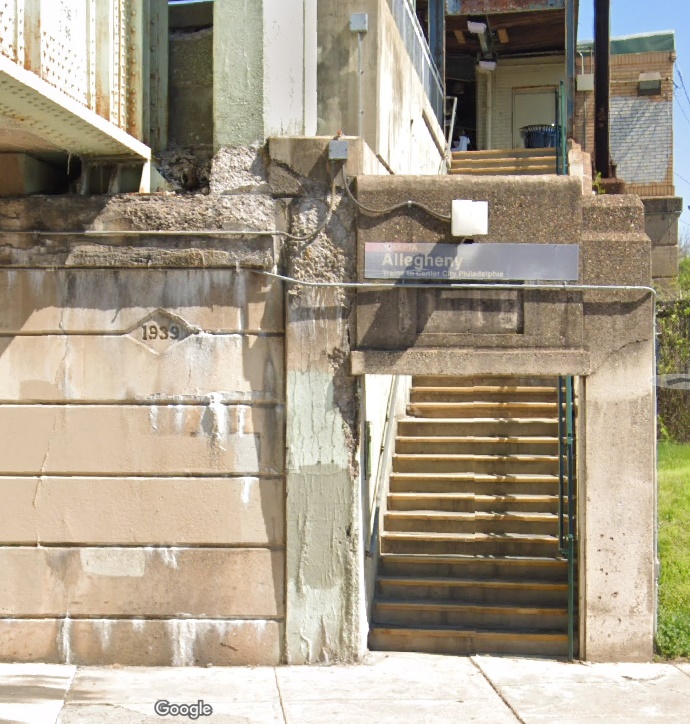

There is one other grade crossing listed in Philadelphia (22nd Street), which I cannot seem to find. It could've been on the Norristown Line pre-grade separation, but then that would mean pre-electrification, wouldn't it?
22nd Street would have been the intersection of the Reading's Norristown line with PRT trolley route 33. (This was, technically, the Philadelphia, Germantown & Norristown Railroad, one of the RDG's scores of underlying leased or partially-owned subsidiaries, and one which actually predated the charter of the Philadelphia & Reading.) Per the dates cast into the concrete bridge abutments (see attached photo), the Reading's grade separations of 22nd Street, 21st Street, and Allegheny Avenue were constructed in 1939.
So yes, there likely were intersecting 11kV/600v wires at 22nd Street for a while. Less clear is the situation at the PG&N's nearby crossing of Allegheny Avenue - trolley route 60. PRT's 1934 service map shows that 60 was then split into east and west sections with the dividing line where the RDG's Norristown line and the PRR's Chestnut Hill line crossed the avenue. A deep dive into the City's construction photos for that project might be educational.
I might have rescued the mold used to cast those diamond shaped dates from the attic of Reading Terminal except it was too large and heavy to carry home on the Crestmont Local.
Alas, engineering history probably doesn't count as engineering experience.
/s/ Larry
Lawrence G. Lovejoy. P.E.
