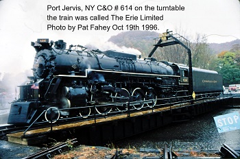

Hi All
Looking forward to riding behind the 614 again,, the last time my friends and I rode behind her was on The Erie Limited, Hoboken, to Port Jervis,,
I know it will take time, to bring the locomotive back into current Federal codes.. Pat.
File comment: Photo by Pat Fahey Kodachome 64
