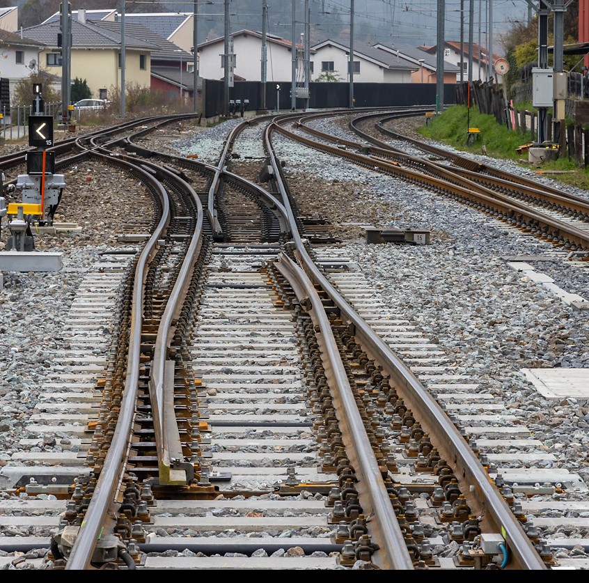

Special trackwork can be fun. Dual gauge just makes it even more fun.
/s/ Larry
Lawrence G. Lovejoy, P.E.
/s/ Larry
Those look like American-style wood-framed buildings on the left, but I can't guess where this is. Australia? Do they have these gauges, what looks like meter and standard gauge?

I routinely save photos of unique specialwork out of professional interest. In this case, I had neglected to take note of the location, but was eventually able to retrace my steps. It's in Switzerland.
https://www.railpictures.net/photo/818712/
/s/ Larry
