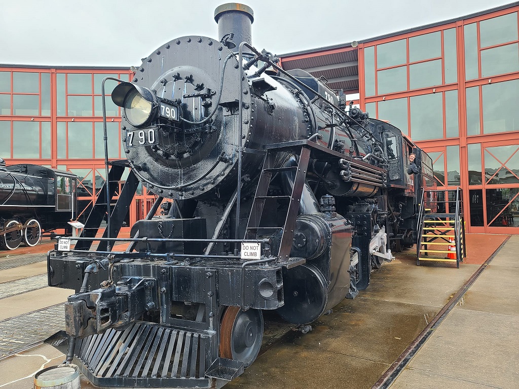

I recently visited Steamtown where I saw 0-6-0 #26 running its yard excursion and a few days later I donated to the B&M 3713 fund. I hope she gets completed one of these days!
What kind of shape is Illinois Central 790 in? I know she hasn't run in decades but the locomotive looks pretty good! Here I am in the cab:
440929411_10232766445533479_1654804413699454009_n.jpg [ 400.38 KiB | Viewed 15867 times ]
