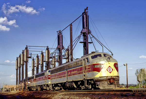

Although EMD would have liked to sell the EL more SD45’s to replace the E8’s, they would have helped the railroad with the program. The technical assistance was generally provided at no charge. Looking at the railroad-issued supplement to the operating manual, I can see how they could have made this system work. They added the current limiting relay so that hitting main generator current limit with speed decreasing, as when climbing a grade, would cut off feed to the throttle switches, drop out main generator field, and pick up the over-riding solenoid in the governor. This would idle the engine, dissipate generator field, and drive the load regulator to minimum field. Combined with the EMD E9 transition circuit, this drops the system into series connection, and the engine would smoothly re-apply power and generator field after the current limiting relay has dropped out. Thus you have a locomotive with fully automatic transition, you put the selector lever in position one and do not have to touch it again.
You can see why EMD would be reluctant to promote this kind of conversion program to their other customers. They wanted railroads to trade in passenger E-units on new freight locomotives, not convert them for freight service.
PC

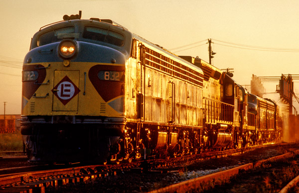

The EMD corporate attitude in the 1970s was truly part of a different century. When I started work there, I asked the boss why there were no copyright notices on many EMD publications. He replied that was intentional, to encourage customers to copy and share public information that supported our product maintenance and sales effort. In our current century I have reminded subsequent owners of that on several occasions.
Remember the days when railroads washed the locomotives every time they went through the fuel track?
PC

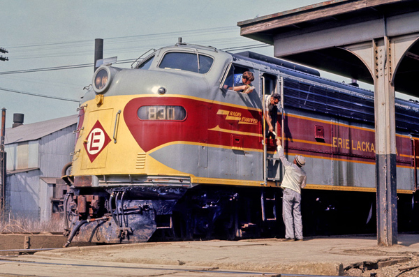

Giving the engineer control of when to allow backward transition reduced the risk of passenger injuries due to unnecessary slack bunching and run-out in the train, particularly when operating with a single unit. Railroads often set transition on E-units so that the two engines would avoid making transition simultaneously.
PC

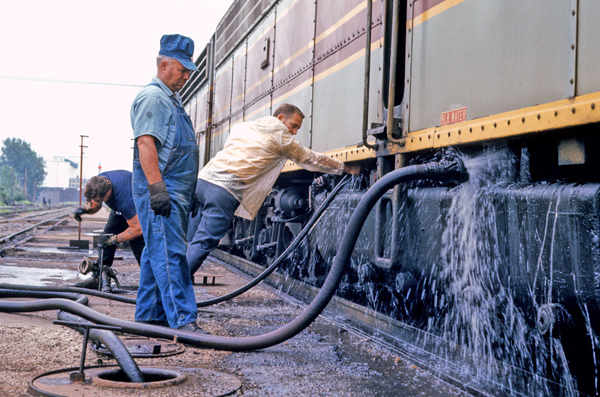

Following up on some items here.
I contacted several EMD retirees to ask about Dick Evans. He dropped out of view in the early 1970s and nobody had any further information.
I agree with Randy, in many respects the Erie-Lackawanna was the Santa Fe of the East, the business attitude and professionalism of the two railroads was quite similar. EMD people were treated well on both roads, and many people you met there became friends for life.
At the other end of the scale were Penn Central and Southern Pacific, two railroads where you were usually treated as poorly as the railroad looked and operated.
Photo: Harold Stone and Richard Byrd servicing steam generator water on an EL Business Train at Marion. The name of the third person is lost in my memory, will add him later if I remember.
PC
