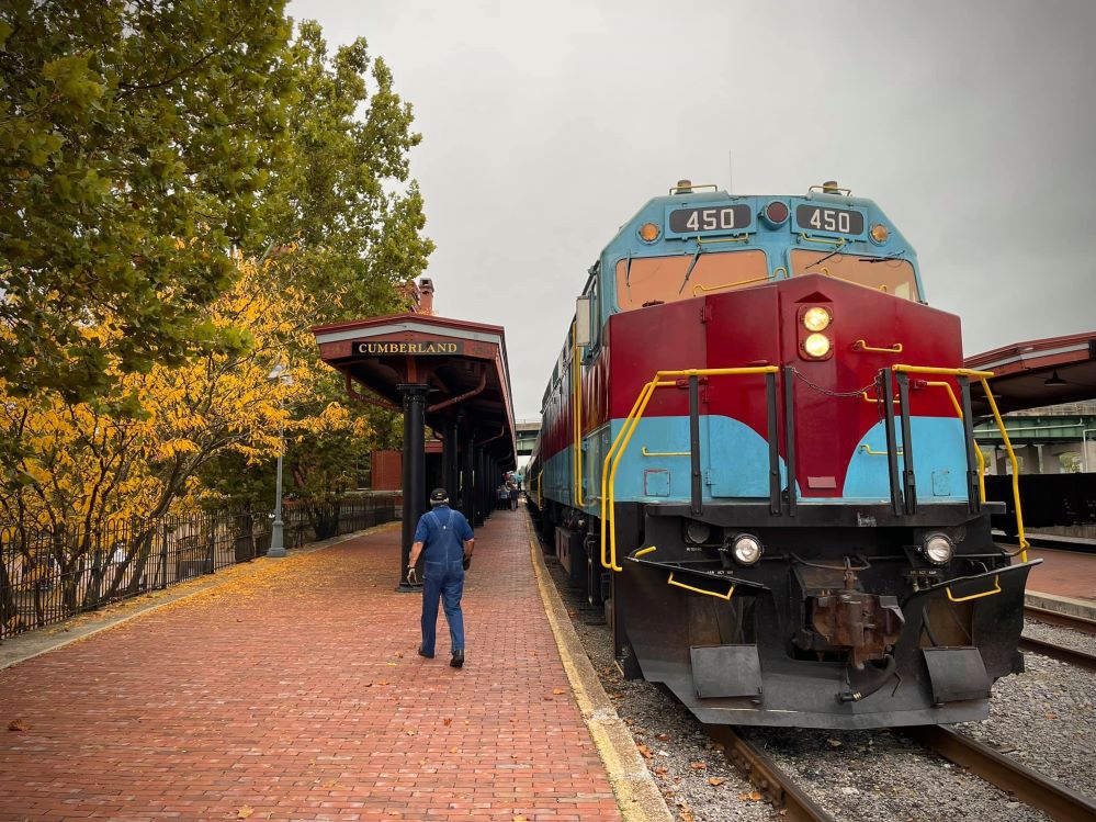

WMSR had one from Larry's they were leasing a few years back, but I believe they sent it back and substituted a GE Dash 8 hood unit. Not sure what the leases cost, but what they gain in fuel costs they likely will lose in replacement parts costs.
244716109_10159438941517970_7563518223516306101_nb.jpg [ 179.29 KiB | Viewed 5390 times ]
