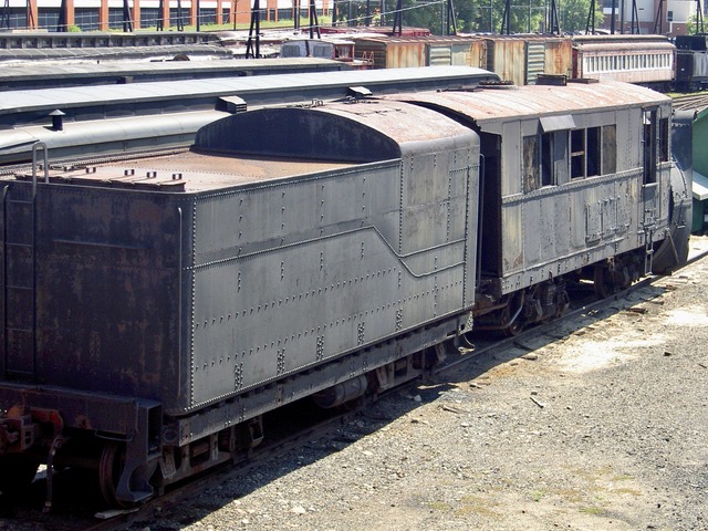

The PRR didn't have any rotary snowplows, nor did any other local/regional railroad (the NYC had one), so hoping the boiler in question came out of some RR equipment goes past wishful thinking to the point of delusion. But the problem is "you can't prove a negative."

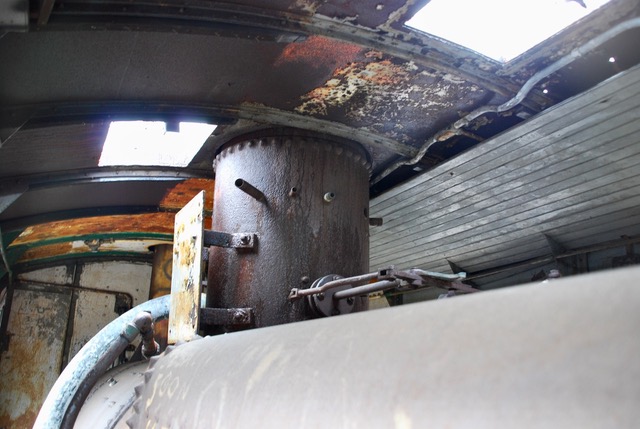

Looking through my photos from May 2011 I found one more photo showing 193's steam dome. The exterior view from 2006 shows the top of the steam dome. In this configuration, it appears that the pipe with the upward bend that is attached to the dome in Mr. Glueck's photos would extend upward through to the exterior and would be visible in an exterior view.
Unfortunately, 193 remains in the stewardship of the NPS where it continues to be subject to NPS's bureaucratic composting protocol.
This LIRR rotary was previously discussed in this thread:
http://www.rypn.org/forums/viewtopic.php?f=1&t=32428&p=213164&hilit=rotary+lirr&sid=1c7e77576778542ff31ab9b8aa77e840&sid=1c7e77576778542ff31ab9b8aa77e840#p213164
These threads also have some information and earlier photos from 193's in-service era:
http://www.rypn.org/forums/viewtopic.php?f=1&t=39037&hilit=rotary+lirr&start=15&sid=1c7e77576778542ff31ab9b8aa77e840
http://www.rypn.org/forums/viewtopic.php?f=1&t=40121&hilit=rotary+lirr&start=15&sid=1c7e77576778542ff31ab9b8aa77e840
http://www.rypn.org/forums/viewtopic.php?f=1&t=44457&p=302648&hilit=rotary+lirr&sid=1c7e77576778542ff31ab9b8aa77e840&sid=1c7e77576778542ff31ab9b8aa77e840#p302648
