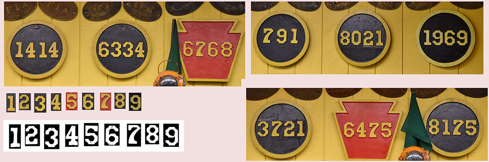

Hey Folks,
Got busy at work, but finally finished this. I made a True Type numeral typeface from examples I found online.
Except for the 5 and 7, the rest of the numbers are surprisingly simple. Most can be drawn from 2 circles and straight lines. The 5 requires a medium-sized circle and the 7 requires a french curve that I didn't have. Just guesstimated this one.
The typeface isn't perfect. Some of the images I used had a bit of parallax, so the geometry is probably slightly distorted. Some of the lines are more curvy than I wanted, but I don't think its a bad first shot. I used a combination of photoshop, windows paint, adobe illustrator and Birdfont to actually make the ttf.
The first link should be the windows version, the second link, the mac version. (These are housed on my microsoft Onedrve.)
https://1drv.ms/u/s!AkHpI_S-8LgminL-fpZ ... x?e=4N2kov
https://1drv.ms/u/s!AkHpI_S-8LgminFc_ON ... h?e=iSwYB2
Anyway, hope this may help someone. Sometime in the future, I'll ask for the offical drawings and digitize those. If anyone has drawings of random PRR fonts, I could tackle that as well... given time. :)
thanks,
Joe

 Post subject: Re: PRR Number Plate Font
PostPosted: Tue Sep 12, 2023 11:45 am
It's hugely helpful, and very much appreciated. THANK YOU!
