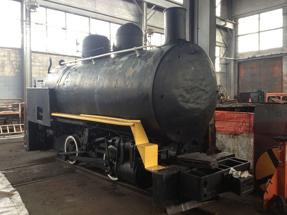

This is one of only 2 true fireless locomotives in Canada, both of which are in Ontario. This one is very unique, built by Porter in July 1943, and is 30" gauge with a "low" clearance cab. It is far from operational, and we have no intention of trying to put any air to it. It is strictly a display item only at the Niagara Railway Museum in Fort Erie.
File comment: 30" gauge Porter

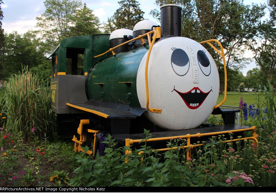

The only other one is Algoma Steel Co. No. 67 in Sault Ste Marie right?
[/quote]
Yeah, that's, ummm, that's the one. How recent is that pic? I knew how it was painted, but wow, that garden really hides it a lot.
I took that in July 2019. It was definitely difficult to properly photograph.
Here's another angle:
http://www.rrpicturearchives.net/showPi ... id=5167525
