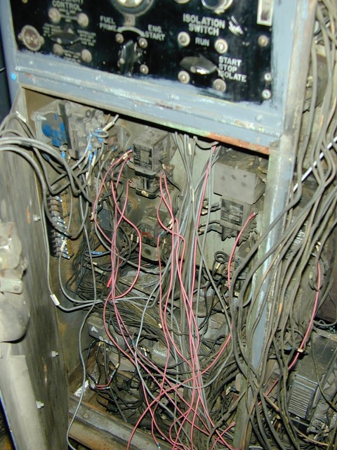

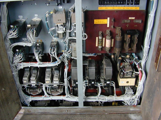

At the factory the wiring was laid out on a pin board that approximated a harness. On a built up unit it's basically pulling wire based on the schematic and more importantly the "wire running list".
Here are before and after pics of a disaster of an SW1200 that we took on some time ago. The pink Exane was the previous owners attempt to keep it running. From experience the scrap neoprene insulated low voltage wire from an SW1500 will fill up three 55 gallon drums.
If you're contemplating a rewire use Exane and high quality connections. A good wire label maker is a must.

Yikes. I can appreciate what a mess that was to redo. Wow.

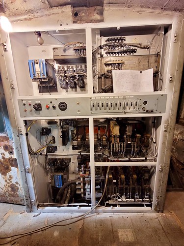

Actually, you’d be surprised at what’s already done above deck. BTW, by strange coincidence, that looks like Rock white paint.

What was left in the electrical cabinet of the L&N FA when they started, had it been gutted?

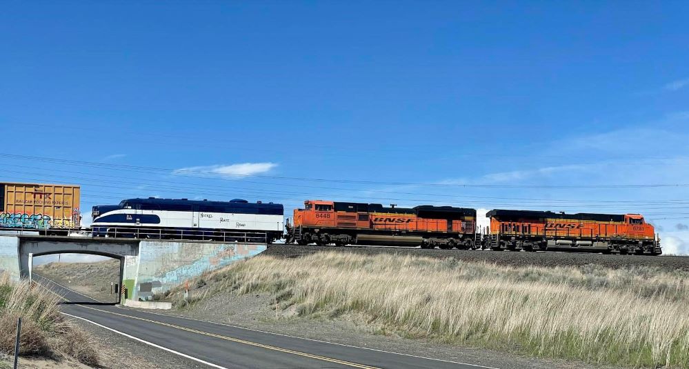

https://www.facebook.com/gvtrailco Photo posted 7 hours ago, the routing is along the Columbia river and presumably through Montana:

Wow, look how small the 190 looks between the engines and that boxcar.

How many loads were behind the PA as pictured.
Thyis reminds me, uncomfortably, of the two MP54s that were pulled apart when someone coupled them between the power and a 125-odd-car train.

Locomotives dead-in-tow in a train are supposed to be right behind the power, at least it was on CSX, so it's where I would expect to see it.

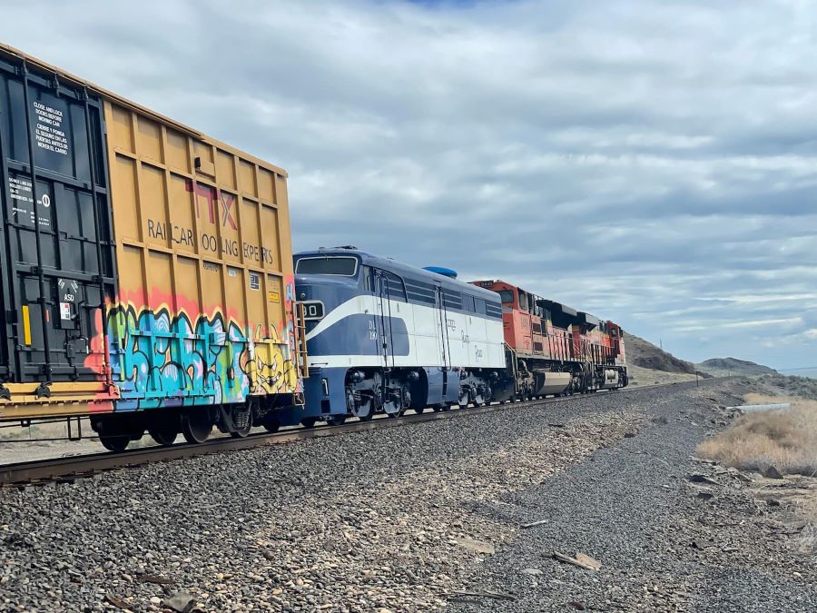

https://www.facebook.com/photo/?fbid=70 ... 0334447840 "UPDATE: scheduled to leave Pasco this afternoon [difficult to say when "this afternoon" means because it was updated at 8:00PM last night so I think it meant yesterday 4/25] putting it passing by Spokane around 930-1030 tonight if departure keeps.
NKP DL190 to depart Pasco,WA later tonight and should be passing by Spokane in the early morning, also passing Hauyard,ID and Sandpoint,ID and continuing its quest east.
This update is for informational purposes only. Please refrain from entering railroad property during this historic journey. Safety first!"
In the comments someone asked if it would be going through Nebraska and GVT responded: "Currently yes, Alliance, Ravenna. Subject to change but approx ETA would be Friday night/ Saturday morning. Very tentative."
