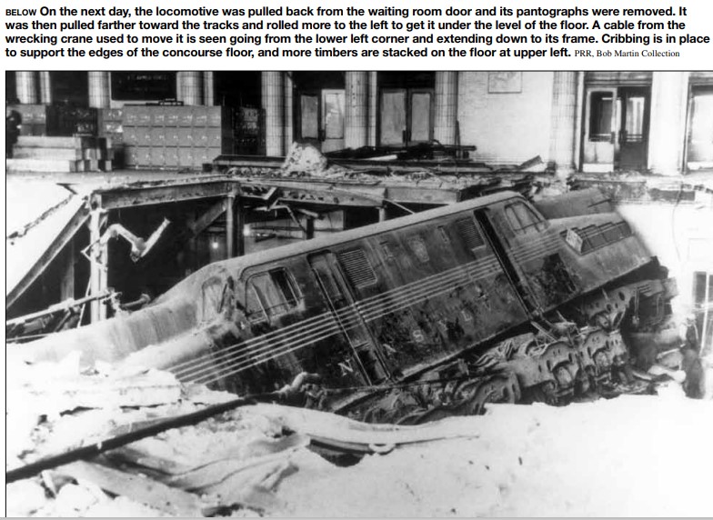

Here a photo to illustrate what happened after the wreck in DC Union Station. You can see the GG1 has been pulled back from the waiting room doors and there is a cable running from its frame past the photographer going to a wrecker outside on the tracks. It is almost below the level of the concourse floor, and will be pulled further until it is below that level.

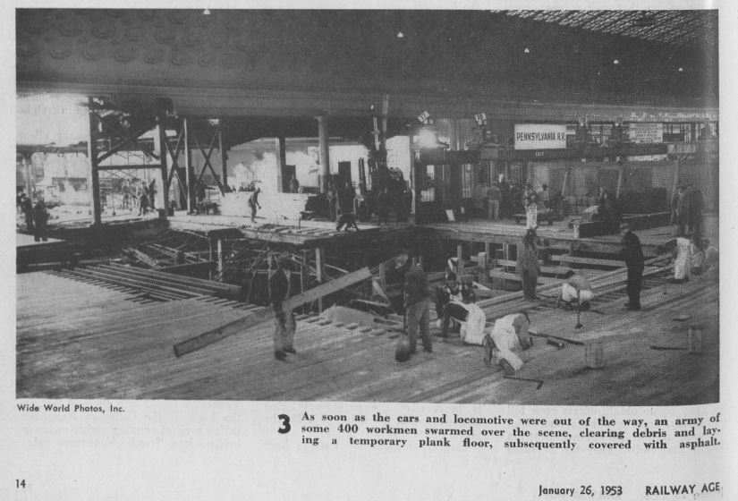

In this photo the temporary floor over the GG1 is nearly finished and soon it will be covered by an asphalt surface. The PRR sent an army of bridge and building teams to the station to work on this around the clock. The locomotive is entirely out of sight below this floor.
Cribbing holds up the edges of the concourse roof and vertical barricades at right screen the work from the public
