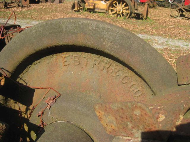

Regarding the EBT's wheels, if someone were to look at a wheel to see if they have one of the popular wheel maker's name cast into its face. Otherwise, one could look in the EBT pattern storage to see if a wheel pattern and chills are there.
I found this EBT wheelset at Cool Springs Park in WV in 2015. I think EBT may have cast their own wheels.
-Philip Marshall
Our museum has a number of commercially manufactured wheels, some of which have the customer's name (railroad, or freight car manufacturer) cast into them. In fact, there is a lot of interesting information cast into them (Manufacturer, city of manufacture, date of manufacture, weight of wheel, customer name, and one even has warranty information, I think). So, railroad name might not necessarily mean home-made.

Philip-
Do you have other photos of the EBT wheel with more markings/context? It does appear that there is another mark on the wheel peeking out of the shadow to the left. It appears to be in a Vulcan truck, so post 1913ish and likely not made by EBT. Probably just an ownership mark.
While EBT had a very capable shop and produced some parts regularly, they purchased parts from outside vendors right from the start as needed. Readily identifiable EBT car wheel photos I have show wheels from AC&F and Lobdell Car Works, and we know Billmeyer & Small supplied their own stuff for the early wood cars. Cost and time were likely the guiding factors in deciding whether to purchase or make in-house. Wheels and axles are a critical specialty item and there were so many manufacturers in competition back then that I doubt EBT would have cast their own car wheels (although I could use another trip through the pattern room) or forged their own axles. The large hammer in the foundry is barely large enough to efficiently forge a new 1880s-era car axle from scratch. They could have purchased raw forged axle billets and shape-turned them in-house, but I doubt it. The one exception to casting their own wheels may have been during the mid-1870s when they were having reliability problems with the inadequate B&S 20" wheels and needed something stronger. They may have experimented on their own a little, but it was around the time EBT started their 24" wheel program (1878) that B&S changed their 24" wheel from a 5-ribbed back to a 6-ribbed back.

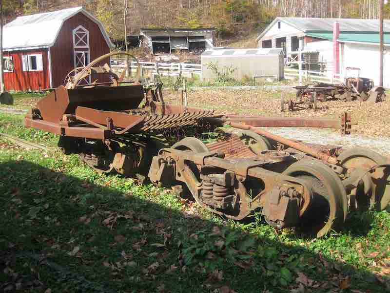

Yes, it was from this pair of Vulcan trucks. I stand corrected.
-Philip Marshall
