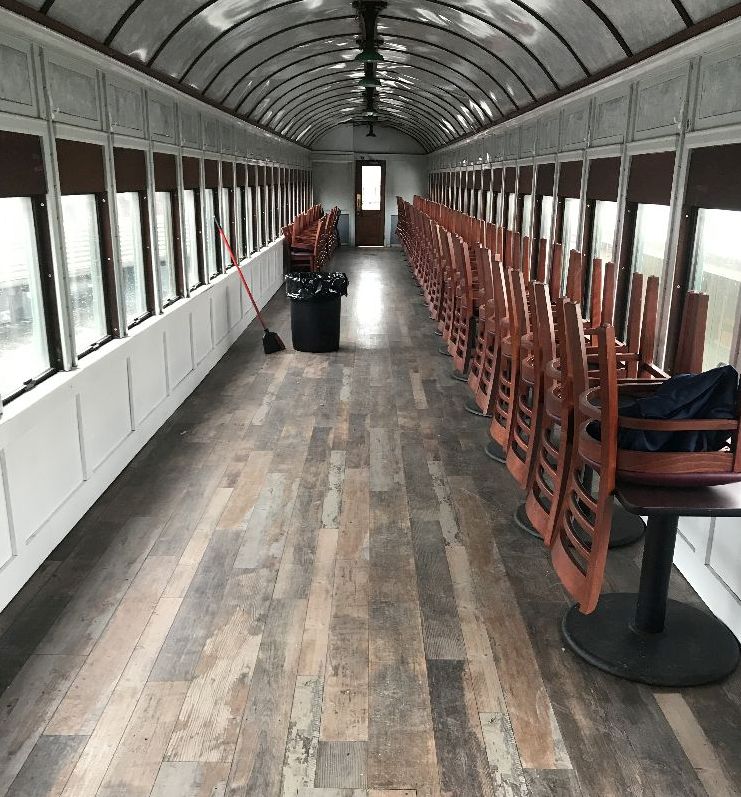

Three years ago we needed to add another coach to our Polar trains in a hurry. We did a quickie interior makeover of one of our ex-SP suburban coaches. In lieu of re-painting the concrete floor the boss decided to buy the clickable laminate flooring. Personally, I'm not in favor of it for historical/restoration purposes, but this car has been modified so much over the last 40 years that it didn't make much difference what we did. It went in fast and easy. The seasonal changes have had minimal effect on it. There is one spot at one end of the car where it buckled up slightly but that was due to not having enough "room to grow" at the sides (probably during the weeks of 90 deg. temps we had last summer).

Note that from the photo, you don't have any seat frames screwed to the floor, which will most definitely inhibit movement of the vinyl plank floor.
Agreed. It's use with tables and chairs worked well. Spilled hot chocolate was easy to clean up, too. Eventually this car will get much more in-depth rehab work and will have walk-over seats installed. When that time comes, I don't think this type of floor will be an asset. I would be more inclined to properly prep the concrete floor and coat it with one of the high-tech garage floor coatings available today.
