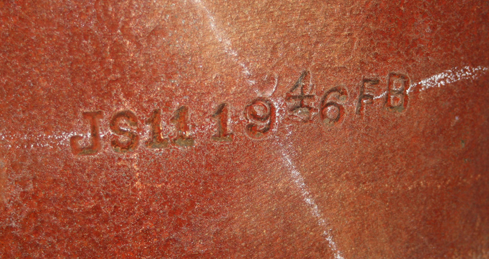

For what it might be worth, both LIRR G5's have Juniata shop dates stamped in their fireboxes, indicating post service shopping in Altoona. Obviously, this would imply a regular "deep down" check and review by PRR.
