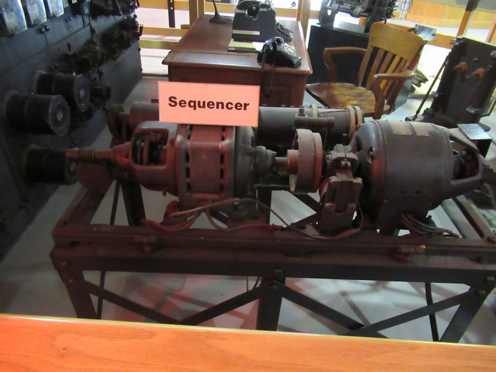

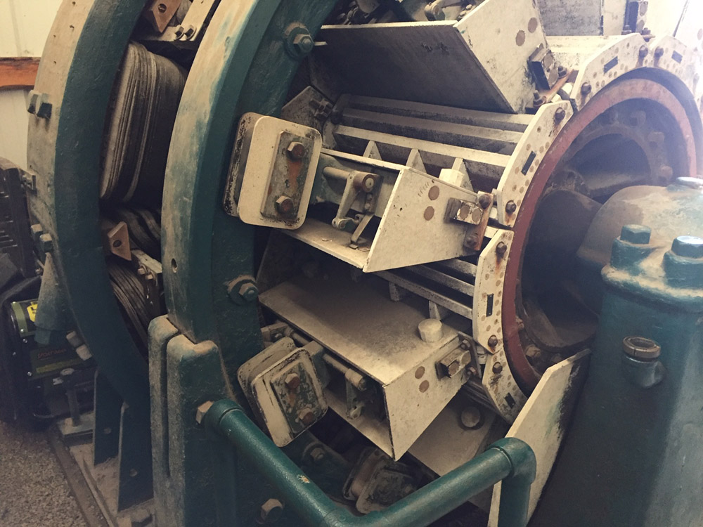

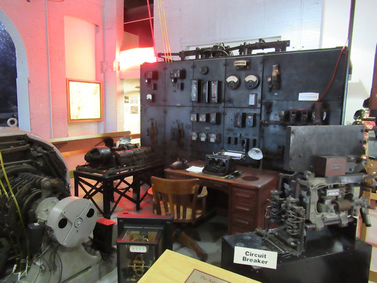

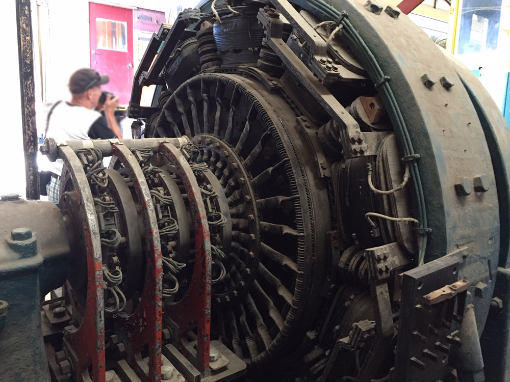

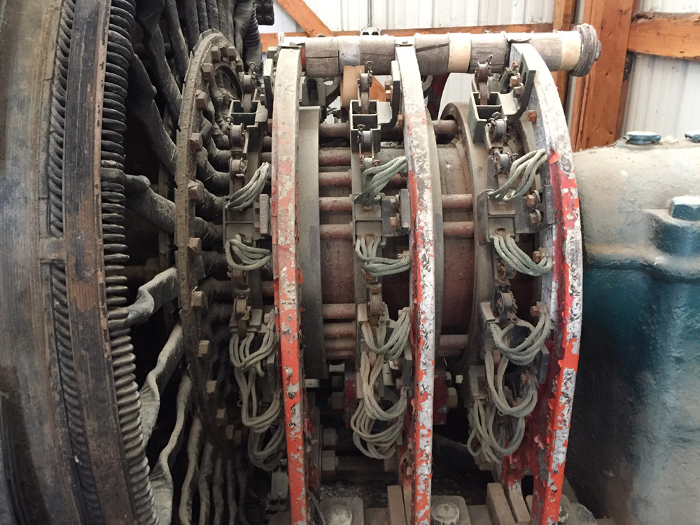

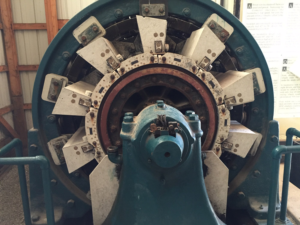

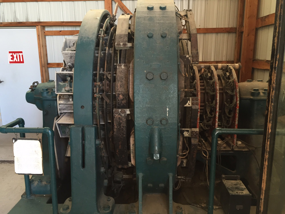

Here are some photos of a rotary on display at IRM. Their explanatory sign said it was a motor and generator in one which is not quite true but my pics are from several years ago and perhaps it has been updated. I'll look next visit.
 Post subject: Re: Streetcar/other electric railway Rotary Converters
PostPosted: Wed Sep 14, 2022 12:01 am
Joined: Fri Aug 27, 2004 2:13 am
Posts: 58
Might this be a booster converter? It's been a quite a while, but I recall something about boosters being able to vary the DC output voltage. All those deflectors on the commutator could be a sign of this being used on a 3rd rail operation.

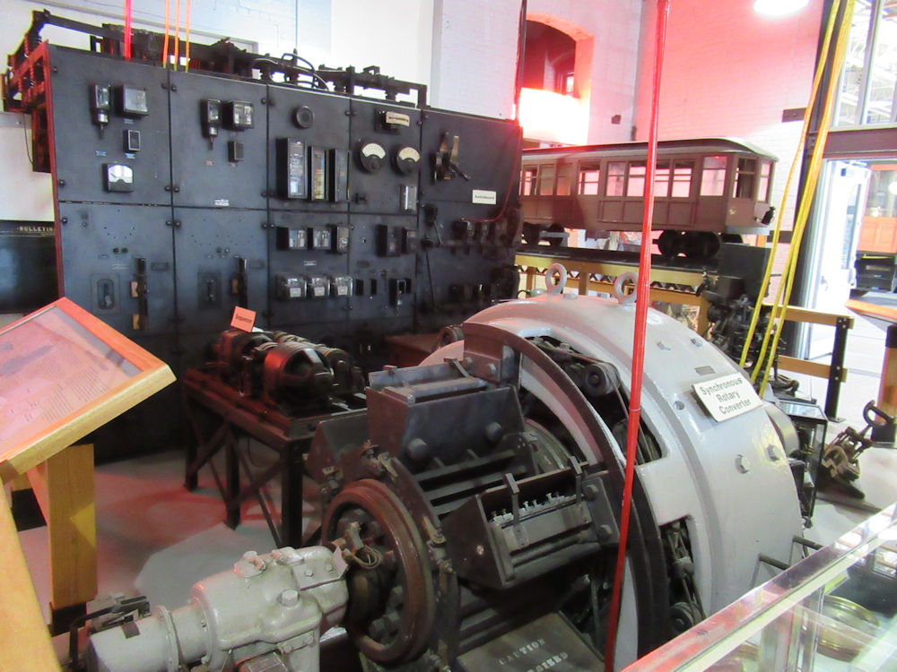

the Electric City Trolley Museum in Scranton, PA has a very good electric equipment display.
