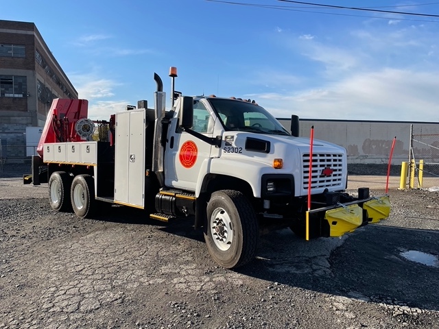

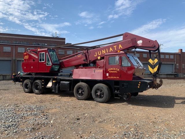

The three typical types of frogs, Butterflies, McCartys, and Burlingtons generally get the job done. We generally use Burlingtons which are probably the lightest of the three to handle. You need a set for low and high rail. Digging the clamps and wedges in frozen ground is a pain. We have light pavement breakers on our Block Trucks to make faster work out of it.
When I worked on the west end of the railroad the preference was for McCarteys which worked very well. They were heavy and we had a couple of sets with some burn outs cut to lighten them up and make them easier to handle.
I never had an issue rerailing loaded cars and I found the trick was to always put some motor oil on the frog to help the wheel kick.
I've included pics of Plan A and Plan B. Plan C is Sidebooms and Plan D is Mantis Cranes.
EBL
File comment: Plan A

File comment: Plan B

Plan A is a respectable truck.
One of our crews decided on a scientific experiment: does a derail work as well when you push a car into a spur as when you pull it out in the intended direction. Turns out it does; hence the need for a rerailing frog.
The frog proved to be a steel butterfly frog. The truck was a 1949 Ford F-2 pickup, red of course. Two of us loaded it in and every downgrade entailed dynamic brakes (2nd gear and engine compression). We delivered it and let the crew on the scene use it and bring it back.
