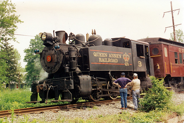

I can't speak for the Gramlings, but I used to run a 55 ton 0-6-0t on fairly level track, and it had no problems with a seven car plus caboose train. The toughest pull we had was in freight service, moving 16 loaded three bay covered hoppers (grain). In both cases, it kept steam fine, running half hooked up at 15mph.

Posts: 490
Where would have this 0-6-0 run at, and was it on a shortline?
Queen Anne's Railroad / Delaware Coast Line Railroad.
1992-1996 era. Georgetown, DE to Lewes, DE - ex-PRR

Is that a USATC S100 that didn't go overseas?
