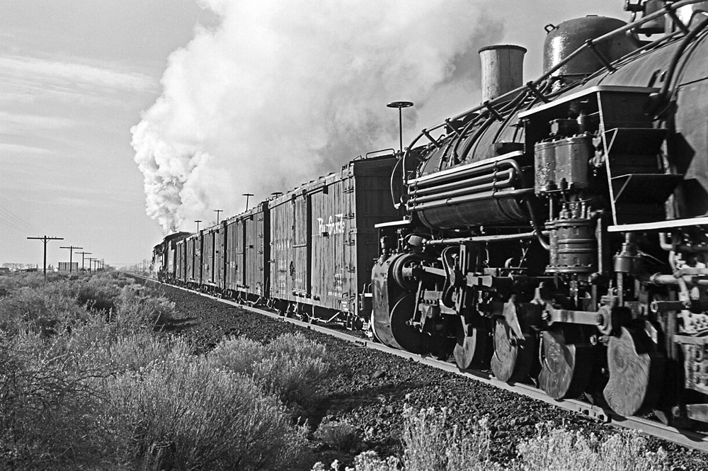

Here is a photo of the last move ever from Alamosa, CO to Durango, CO (December 5 & 6, 1968) with DRGW No. 473 towing a handful of freight and passenger cars and DRGW No. 481 dead in tow. Note main rod stowed on the running board. The rods remained on the running boards until 1981 when myself and others prepared the locomotive for return to service on the new Durango & Silverton NGRR. Photo by Ernie Robart.

Interesting that 481 was hauled dead to Durango, it had its main and eccentric rods dropped. When they delivered all the locomotives to the Cumbres & Toltec a couple of years later, they left all the rods on, and the dead engines "sucked wind" all the way from Alamosa to Antonito, and eventually all the way to Chama.
They seemed to survive the ordeal.
