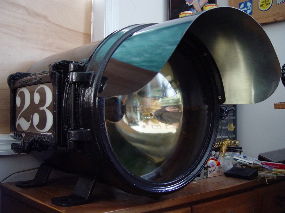

I restored a GG 14" w/round steel case a few years ago. Unfortunately I didn't get good pics of the interior. The ESSCo retainer ring was not a casting but a convex stamped steel ring. The clamping fingers were not the same diamond shape as P-N used - they are square(ish) with the screw hole centered near the outside edge and arched over the retaining ring. Look near the bottom and you can see the ring and a clamp.
IIRC the reflector also sat in a pressed steel cone that's not as thick as the P-N version (would have to look at it again), but they used the same felt crescent padding arrangement as P-N. Note the ring cast in the center of the lens.
