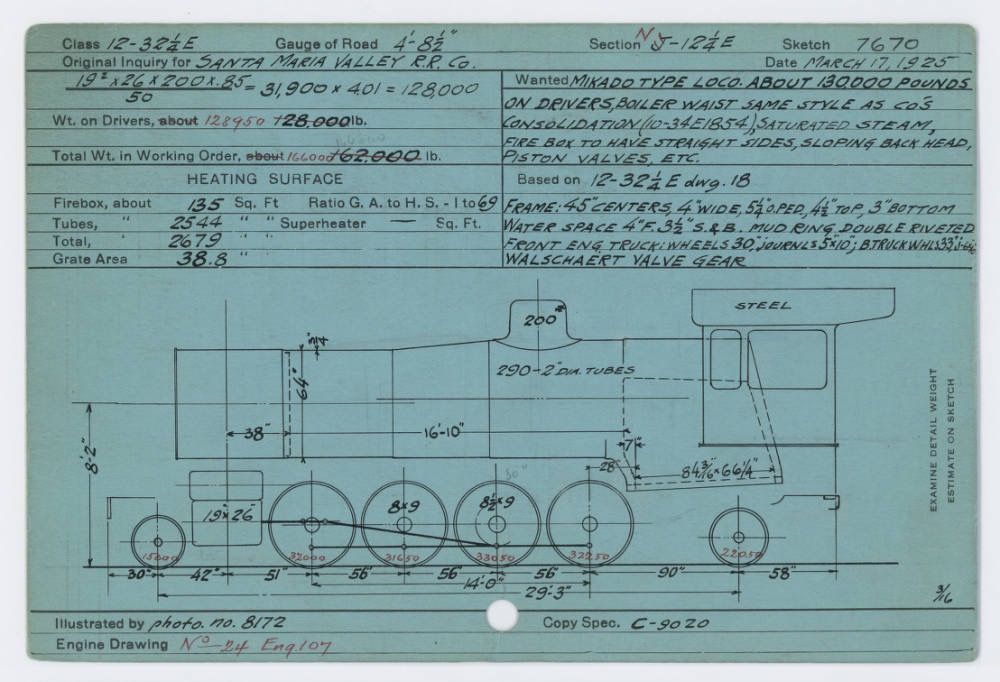

Jeff,
thanks for finding the pics in Astoria. I was always to lazy to browse their hundreds of restoration photos.
Yes it looks like NOW it has flues for superheater tubes.
But that did not convince me that is was build this way in 1925. Within almost 40 years with SMV
it could easily superheated sometimes. Not a big deal. Class I railroads did this with thousands of locomotives.
If the engine has flawless maintenance records and there are in possesion of the current owner that should be
easily found. Especially a mandated boiler/superheater test with a DATE!
All factory documentation say not superheated.
I know, I know there are failures within Baldwin records but mostly numbering issues.
I doubt with ICC, federal and state requirements and tests that an issue like boiler superheating was forgotten!
Last edited by linkthebutler on Tue Sep 07, 2021 3:06 am, edited 2 times in total.

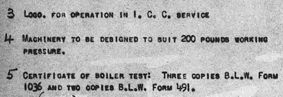

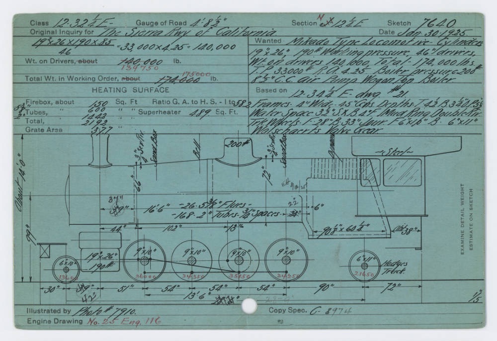

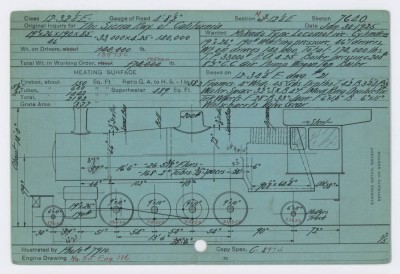

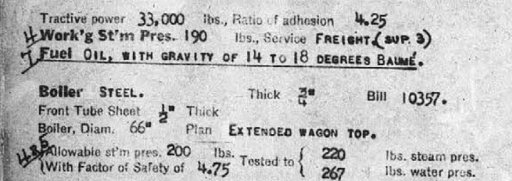

Sierra #34
I am sure all engineers and fireman within the preservation community ran that engine
with 200lbs boiler pressure since the 1960s and hopefully sometimes in the distant future
(depends on Mr. Kepners ability to "let it go").
BUT it was build and delivered with 190lbs plus the option to upgrade to 200lbs.
What I think Sierra did after 1925.
As I say above if there is a flawless maintenance documentation it is easy to find.

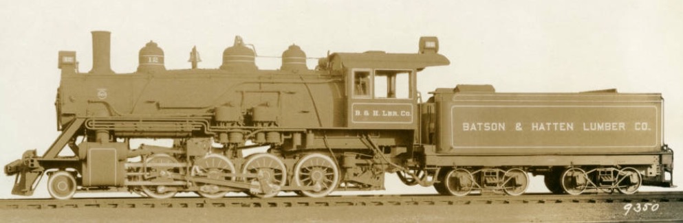

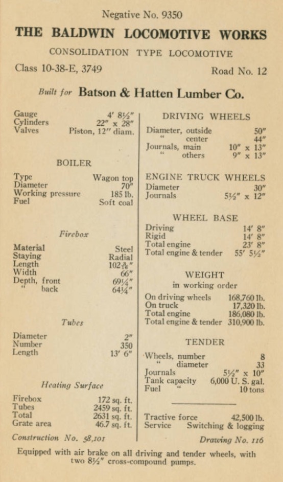

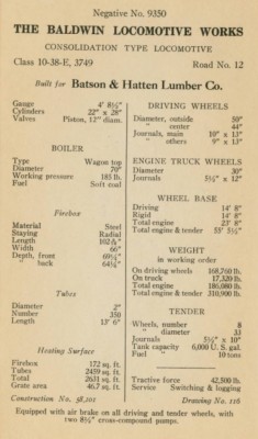

regarding saturated locomotives with piston valves
The most odd one I know of is the Batson & Hatten #12 logging Consolitation made in 1924.
Made for a lumber empire in MS it was equipped with 2 cross-compound air pumps -
what let me guess very heavy trains - but not superheated. Strange!
Interestingly that engine put much more TE to the drivers then the common logging Mikados of that time.
I guess the owner had access to turntables on the end of the railroad.
Right now on display at the Museum in Caldera, AL.

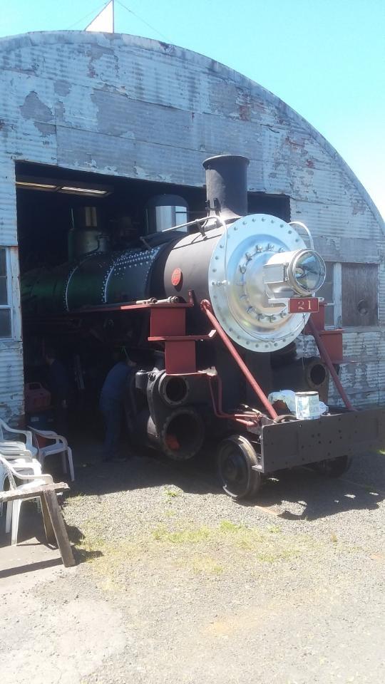

Here's the real scoop. The SMV 21was indeed ordered saturated with no superheat. In 1935 when the locomotive was only ten years old, the Capt. had superheat installed at the Southern Pacific LA shops. We have the blueprints by the Superheater Company that detail the installation. We believe that they replaced the entire firebox at that time, as there are now Flannery flexible crown stays and not the Baldwin "expansion" stays that are depicted on the original blueprints. We have replaced the entire firebox as well, making it the third.
The locomotive was ordered with the smoke box lagged and the thickness is 1" which when matched to the 1 1/2" thick on the ajoining boiler course, make a smooth transition.
As mentioned above, the exact phase " as attractive as possible" appears on the Baldwin order form.
Also, the original builders photo shows a much taller smokestack very similar to the other locomotives mentioned above. It seems to have gotten changed during the Superheater conversation.
Hope this answers some questions.
John Niemann - Astoria Railroad Preservation Assn.

John forgot to mention that #21 now rolls.
