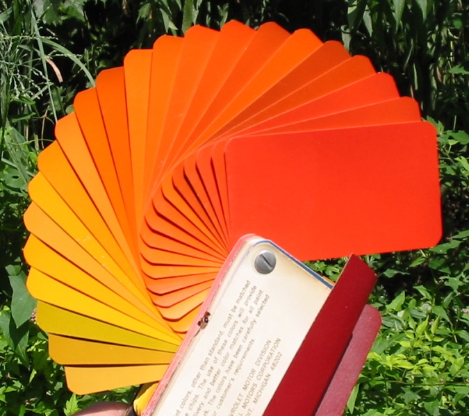

On the computer, using 16 bits per each red, green, and blue channel produces a total of 281,474,976,710,656 different colors. I think I'll stick with just the actual paint chips for now.
In my 1954 DuPont catalog, WE5562 matches REO Truck Yellow, 93-71369, and WE5569 matches 93-1021, an unassigned fleet orange.
Since I really didn't have to cover the oranges too extensively in my Reading thread, here are all the cards specifically labeled as "Orange" from the 1972 Chevy fleet fan deck. 082 Omaha Orange seems to be missing but many manufacturers tended to use that one as a standard production color around that time. 014 Imitation Gold is all the way toward the lower left...

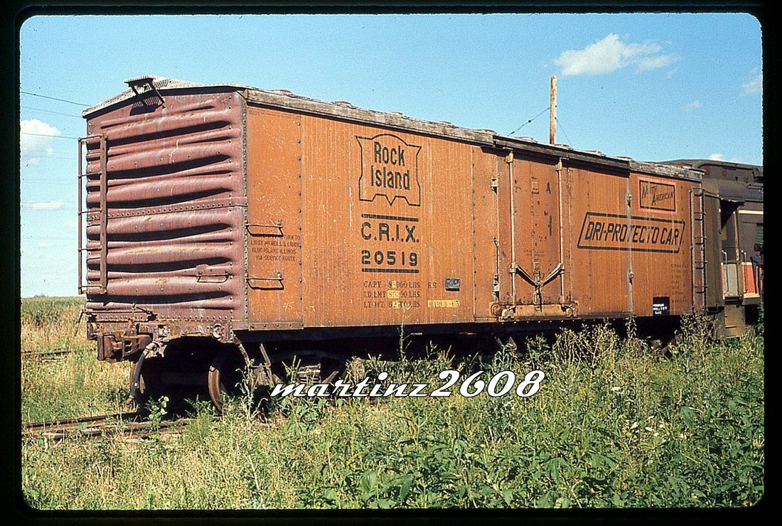

I saw this IRM car on Ebay. Older photo.
Looking at the small stenciled numbers, I see they were changed.
Why would they re-rate the car? What could be some reasons?
CAPY 88000
LD LMT 89200
LT WT 52700??
 Post subject: Re: Two Months - Four cars painted
PostPosted: Sun May 29, 2022 6:37 am
Posts: 2071
The short answer is: Any time a car hits the shop for repairs, modifications or a rebuild, it gets weighed. That’ll change your empty weight or “LT WT” which can affect your capacity and sometimes the load limit. If you notice, to the right of the LT WT stencil, there is a re-weigh location and date stencil that has also been changed. That’s when and where the work was done.
Welcome to the Intercahange.
