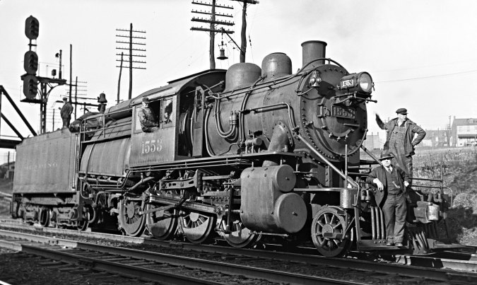

Kelly, here's #4 down at Birdsboro demonstrating at least four out of the six axes of motion not too long before you guys got ahold of it...
https://www.youtube.com/watch?v=7pmRy0KkCRg
And yeah, when driving a Reading road camelback at track speed, you might not have anywhere to bail after a rod cuts loose, except perhaps straight out the front door, but then that running board looks like two-inch thick boiler plate underneath the cab there...
 Post subject: Re: Camelbacks: Did the ICC ACTUALLY Outlaw Them??
PostPosted: Wed Aug 18, 2021 5:29 pm
The engine is an I-8-s-b 2-8-0. The last one was retired in 1948.
As to a previous discussion, note the twin feedwater lines from the cab to side-by-side check valves.
The engineer is sitting "up on the cab" on the armrest. That's essential to see around the firebox when backing but optional going forward. The radius rod has him in reverse. See the crewman on the tender to pass signals.
The alternate escape route is up through a door leading to the walkway along the firebox then down the backhead and onto the tender.
