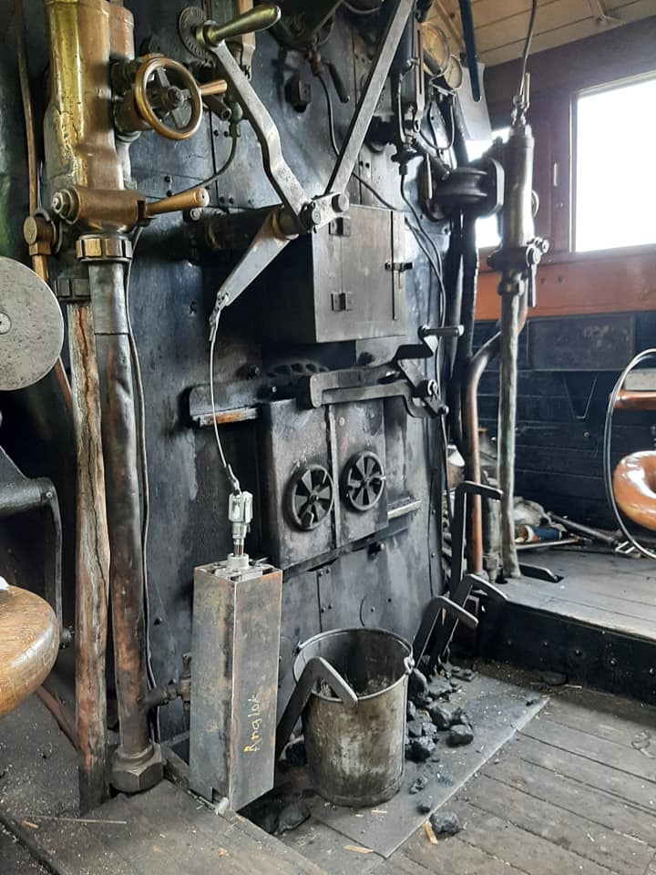

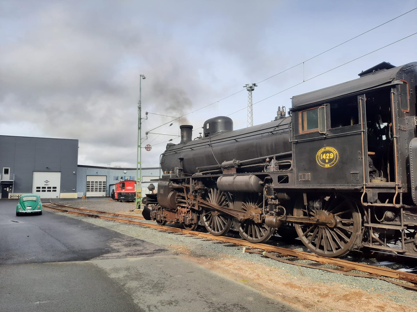

While not PTC, the Swedish railway museum has recently retrofitted one of their B class locomotives with "Traction Cutoff" for an ATC signal system. I believe the system also has the ability to big hole the break line with a passed at danger signal. They even managed to work in a dead mans pedal to get the system approved!
File comment: The retrofitted B class locomotive in discussion
120235421_4578157575558544_5281201700783573599_n.jpg [ 198.57 KiB | Viewed 10837 times ]
File comment: Their solution to cutting power from the locomotive is a hydraulic cylinder that can force close the regulator.

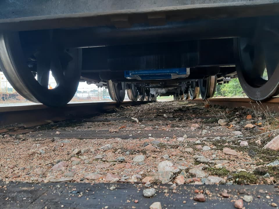

120201078_4573453716028930_3566228645353585938_n.jpg [ 94.16 KiB | Viewed 10837 times ]
File comment: The fitted belise on the locomotive's front truck
120202554_4573452496029052_7008004195650235689_n.jpg [ 92.67 KiB | Viewed 10837 times ]

For those keeping score at home, the "balise" under the lead truck of SJ 1429 above is part of the European PTC system. It is a transponder used to tell the locomotive where it is and for the train to tell the railroad who it is. It also sends up to date civil speed enforcement data including permanent speed restrictions and temporary speed restrictions.
There are corresponding balises between the rails.
Please see Wikipedia which mostly describes the Eurobalise: https://en.wikipedia.org/wiki/Balise
Yes, there is something better than I-ETMS.
And, oh yes, nice VW bug.
