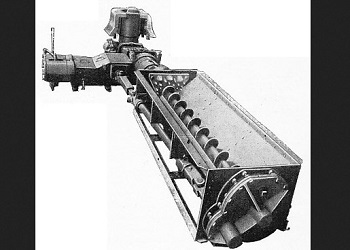

Posts: 605
Location: Milford,Mass
Hi
The N&W # 611 can be repaired by shops in Spencer, NC, or be repaired by the Norfolk Southern Railroad shops.
Yes, I do agree with the posts about moving the locomotive to Strasburg, but that would require, a lot of coal shoveling by the crew. And trying to keep the locomotive hot, by hand shoveling, is a complete another matter.
But the locomotive would still have a broken auger screw and still have to be repaired. All the coal has to be removed from the tender in order to get access to the screw.
For those of you, I am attaching what a Stoker screw and auger look like. This photo might not be the same type of stoker that is in the N&W 611 but will give you a basic idea of what it looks like.
Yes, it is a setback, but it can fixed.

A question from the back of the classroom in Stoker 101.
How is the stoker powered? Steam, air, low voltage motor from the dynamo?
Thank you.
Wesley
 Post subject: Re: The N&W # 611 ti return back to Strasburg RR in 2021
PostPosted: Wed May 19, 2021 7:09 pm
Usually it's a horizontal inline 2-cylinder steam engine that turns a shaft which is geared to turn the auger.
If you look at the picture in Pay Fahey's submission above, the engine is on the left at the far end of the auger. The engine is usually under the cab on the fireman's side (on a Reading T-1 you can see the cylinder heads there; Pat's submission pretty much puts the stoker engine under the cab). PRR and N&W sometimes put the stoker engine in the tender.
