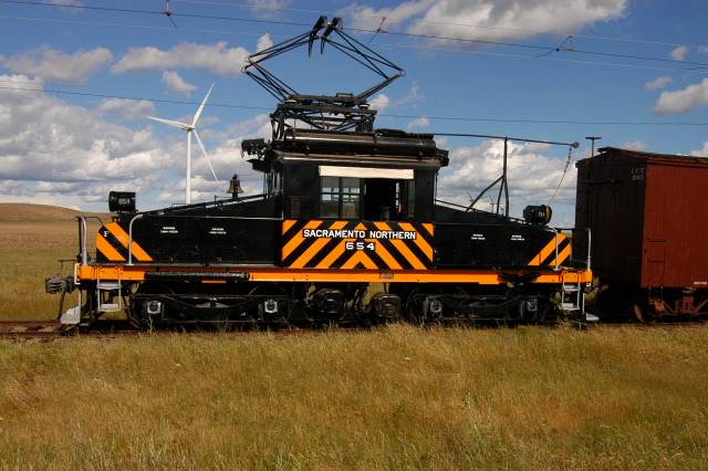

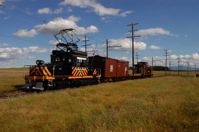

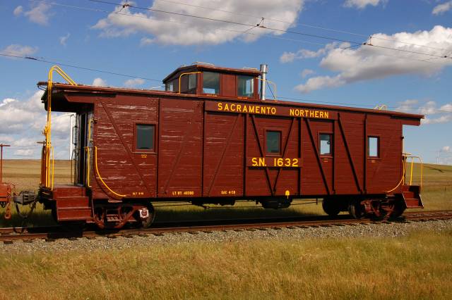

I would add that "appropriate" should also agree with the restoration objective of the museum. For example, the Western Railway Museum's objective has been to restore its operating line (Sacramento Northern) as closely as possible to its original condition as built in 1913. This includes 70-pound rail, which is not appropriate to a GG-1 or other large locomotive.
Attached are some photos of an SN local freight train which we assembled several years ago. A local farmer bringing products to the station at Rio Vista Junction would have seen similar equipment on similar tracks. The only anomaly is the modern wind turbines visible in some scenes.

Well, and how clean and shiny everything is.
