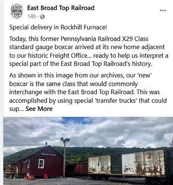

File comment: Photo copied from Face book.
Hi All
I found a photo of the standard gauge Pennsylvania X-29 Boxcar on face book.

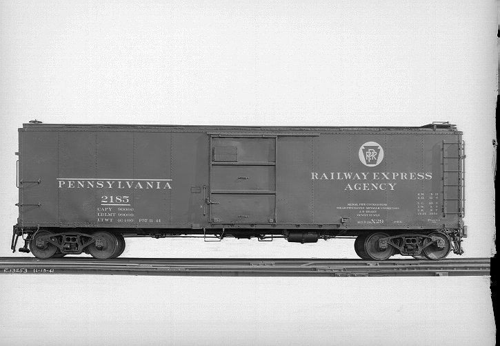

Les Beckman wrote:
T.E.P wrote:
Said X29 is neè-PRR 6866, an REA assigned car, by way of Kiski Junction and Rosebud Mining.
T.E.P. -
Thanks for the road number. So, would PRR 6866, as a REA assigned car, have had a different paint scheme when in regular service for the Pennsy?
Minor correction. Original number was PRR 54491, built between 11/1929 and 01/1930. Taken out of service and rebuilt in July 1934 for express service and renumbered PRR 6866.
To answer the question, though, the short answer is yes.
The REA-assigned had a variation of the 'Circle Keystone' scheme, along with steam and signal lines, high-speed trucks (2D-F7 or 2D-F14/Young), AB-1B brakes with a quick service valve suitable for passenger service, and additional sill steps and grab ions.
File comment: PRR X29 as rebuilt for REA service.

T.E.P. -
Thanks for additional info including photo of a similar PRR Railway Express Agency X29 car.

PRR 6866 was rebuilt and assigned to mail and express service in passenger trains. It received trucks with improved damping, also graduated release air brakes and steam and signal lines as well as a geared hand brake wheel.
Passenger X29's remained painted Freight Car Color but the lettering reflected the passenger assignment, often including "Railway Express Agency" although the cars were also used to move storage mail.
An X29c was 9' 4 3/4" over side sills and 13' 3" high with the geared hand brake wheel, mounted to the car end, meaning it easily fit in Penn Station NY without imperilling the brakeman setting the hand brake.

Which means it is the wrong car to illustrate what they want to... Hopefully they will reverse the changes to make it back into a freight car and paint it in the freight lettering scheme.
It's close enough, and the price was right. Most of the express service X29s were later returned to freight pool service or MOW service anyways, retaining their express service trucks.
