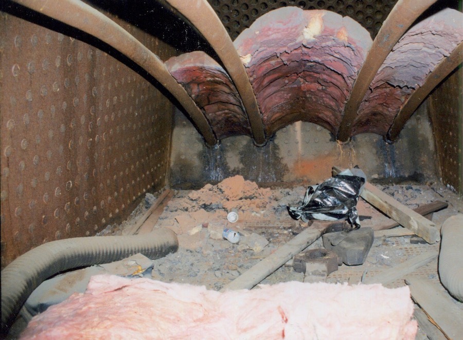

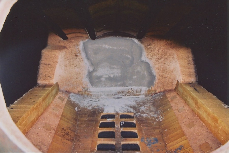

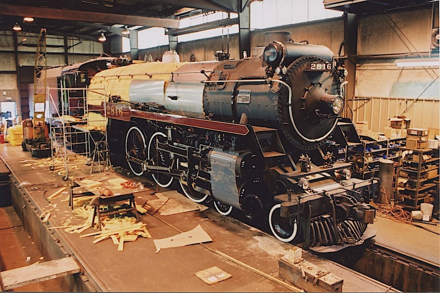

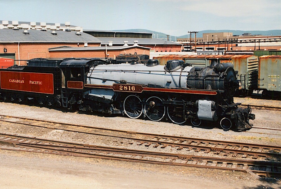

Cool pics of 2816. CP just followed the blueprints for oil fired 2800s. It was set up identical to the 2860.

M Austin
re. CPR drawings.
Pretty much.

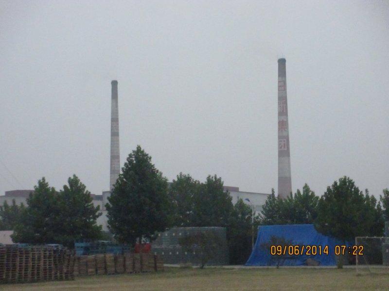

softwerkslex wrote:
.... China will have no problem building coal electric plants, using them for 10 years, and then tearing them down. Even in China, coal is not the long term plan.
I spent 7 months in Downtown Wuhan China (2 transit stops from the main 3-way interchange) in 2014 on various projects. One was assessing a 1 million bottle per day factory for thermal efficiency. In the photo, you can see a square grid on the left smokestack. After the first walk through, ending up between the 2 stacks, I saw the left stack surrounded by a structural steel grid. With everything I had seen I asked the vintage of the plant, "1950s, 60s...?" No. 1 on the left was built in 2007 and no. 2 in 2009. The factory had gas producer furnaces they were running about 400F to cold for maximum CO production. I could have saved about 10% on their fuel bill, but since once you touch one aspect and all the other aspects are similarly compromised, when does everything start to fall apart?
This as a prelude to slight perception modification "10 years, and then they fall down..."
Rail content: CHR 4 HIGH SPEED meets in 12 minutes @ 300 kph(186mph)

On the 2816, is the burner under the fire door pointed forward or at the front of the firebox pointed back ?
US practice was under the throat or towards the forward end of the firepan pointing back, no brick arch. Canadian practice is burner under the door pointing forward, with brick arch. The small Welsh conversions used a central burner pointing out in a ciircle. SLM/ Sulzer has a cluster of burners surrounding a pilot burner. I hear the 3 Rivers Rambler is using some form of multiple burner arrangement, wish I knew more about it.
