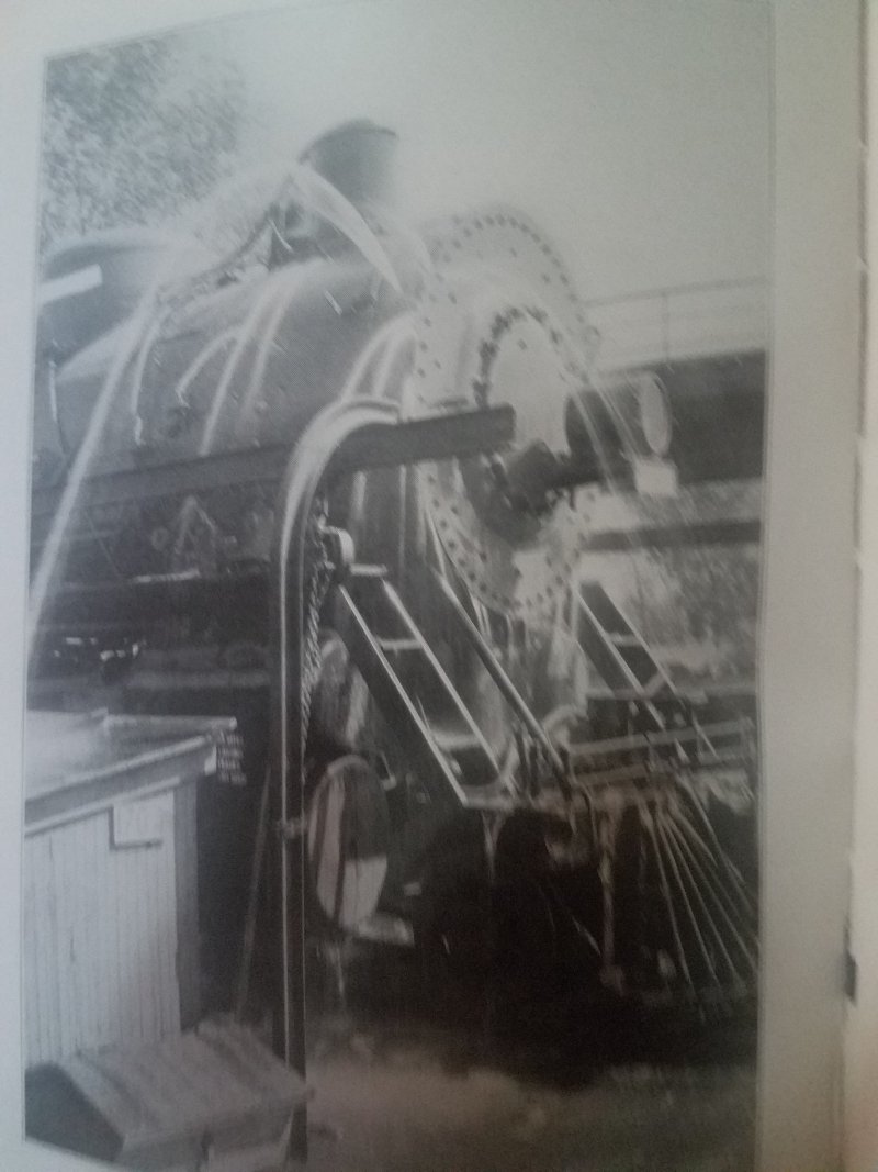

here is a different hydro test.
Robby Peartree
 Post subject: Re: Hydro testing issues
PostPosted: Sun Dec 20, 2020 4:19 pm
OK, I'll bite -- how in the SAM HILL did that happen???
