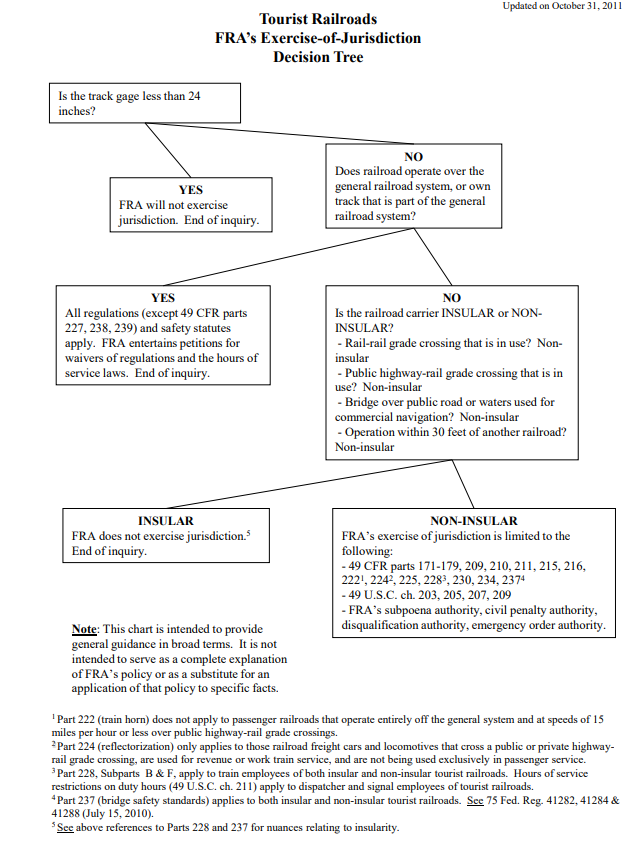

Hello
In my job with the SMART-TD, I deal a lot with the Various state Corporation commission and the FRA.
Attached is a photo of the FRA’s Exercise-of-Jurisdiction Decision Tree, its easy to read and figure out.
For railroads that fall into the jurisdiction of the FRA, There are a number of states that have Corporation commissions the work with the FRA to regulate the railroad in the states.
