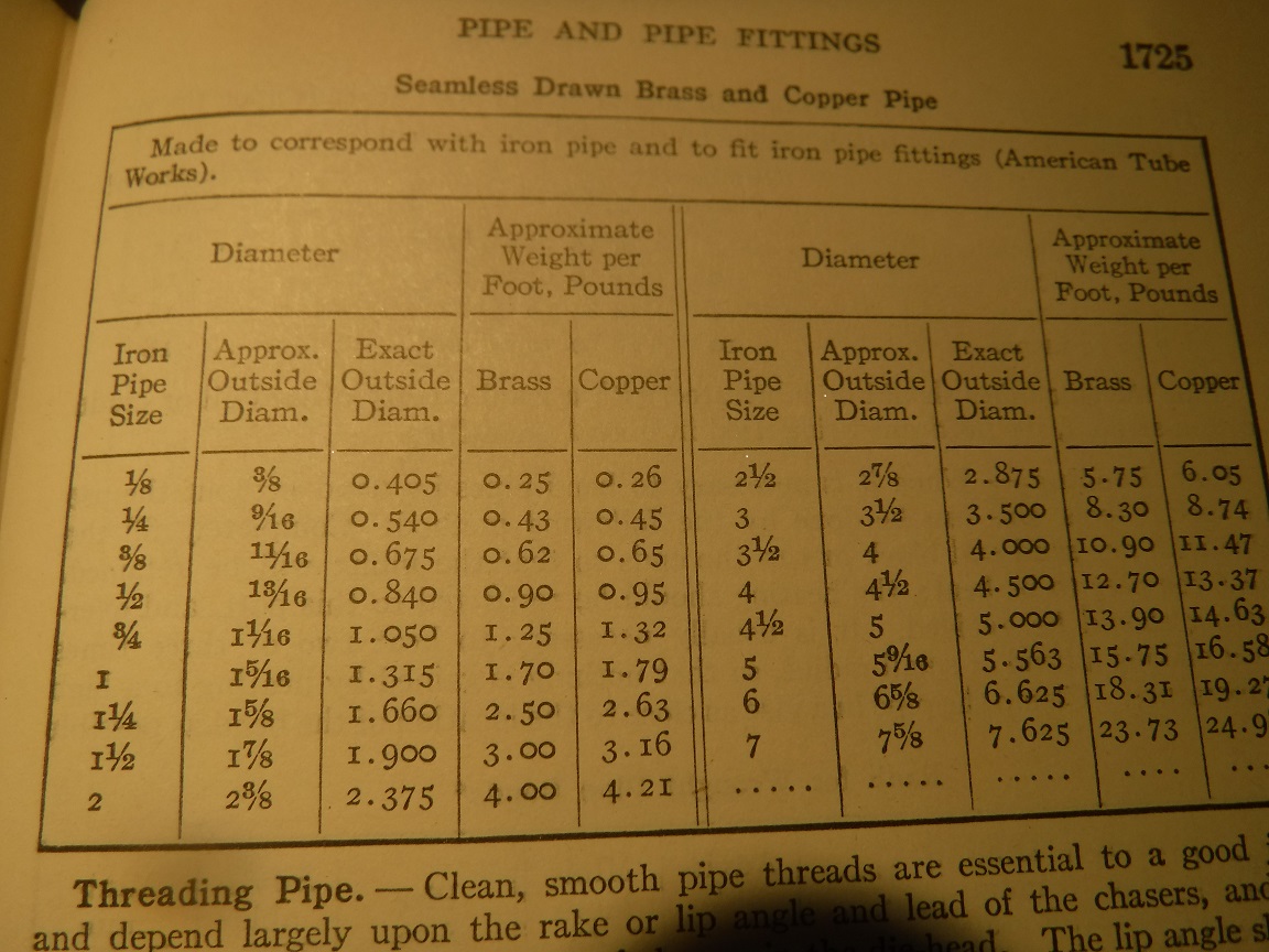

From the Machinery Handbook, 11th edition, 1943 we see the table of copper pipe, (not tube) sized to match the dimensions of iron pipe. NYCRRson says that he disagrees with my statement that CPS (copper pipe sizes) is the same dimension as iron pipe, but we see here it is indeed the same. In fact, I have purchased copper in CPS which is identical to iron pipe sizes even down to the available lengths of 21 feet. I agree that it is a tangled mess unless you actually work in the pipe world and then it is only a little messed up. C.W. Craven is correct in that the B-42 was published in 1922 however I don’t think it applies in my original question. Although I asked about the Hancock publication, my Sellers catalog 1902 makes the same distinction in iron vs copper and different sizes.

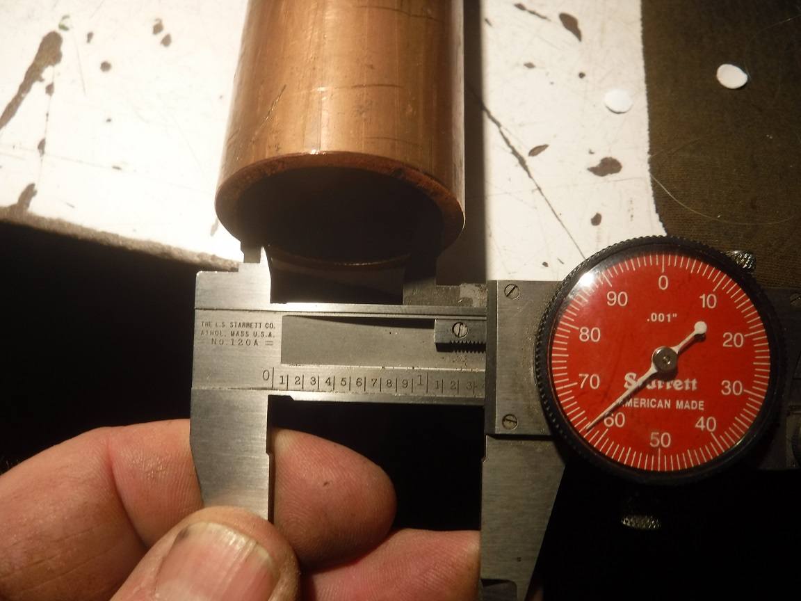

We also see the pipe being measured and we find that the od is 1.660 which corresponds to the od of 1-1/4" iron pipe.

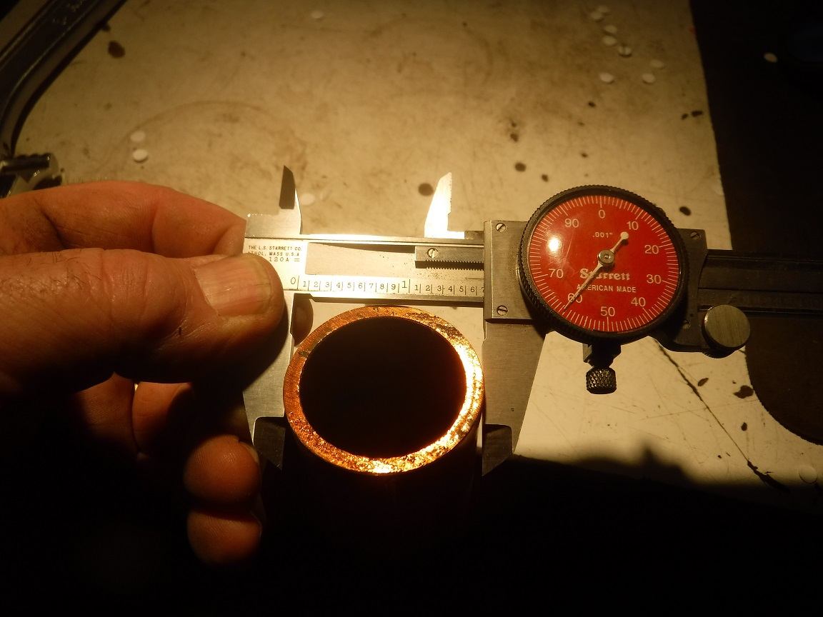

And we see the id being measured and with a little math it turns
out the the wall is .140 which is the wall of 1-1/4" iron pipe, schedule 40.

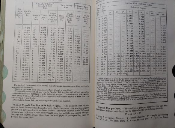

Maybe this will help. From my 1957 edition of Machinery's Handbook, 15th Edition.
I'm not sure if this is any further help.

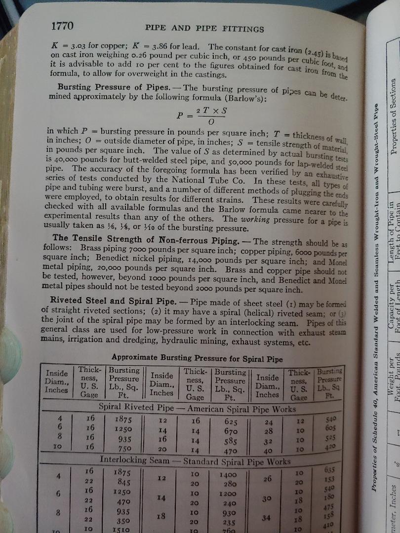

Interesting. The 1-1/4 pipe with 0.140 wall thickness would have a bursting pressure of 650# according to this formula. If we go with a 1/6 factor of safety as suggested, this pipe schedule would not be satisfactory for 200# boiler pressure.
I tend to think this verifies the premise that with copper pipe, a thicker schedule would have been necessary to safely handle the boiler pressure, and thus smaller ID. In order to avoid wire-drawing the steam you would have gone up one pipe size when using copper. Now, you steam guys have to explain to me what an "inspirator" is!

Interesting. The 1-1/4 pipe with 0.140 wall thickness would have a bursting pressure of 650# according to this formula. If we go with a 1/6 factor of safety as suggested, this pipe schedule would not be satisfactory for 200# boiler pressure."
The 1957 version of Machinery's Handbook shows 1 1/4" pipe with .140" wall thickness as "Standard Weight" (Standard wall) pipe. "Extra Strong" 1 1/4" pipe has a .191" wall and Double extra Strong 1 1/4" pipe has a wall thickness of .382".
I'm including a scan of the page. Notice the right hand page with the more familiar pipe schedules listed

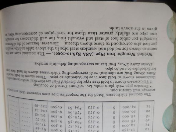

The print in the previous photo didn't come out well. Also, when the newer standards for pipe were adopted the "Double Extra Strong" pipe has no corresponding Schedule #.
