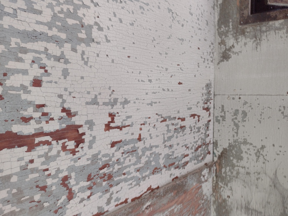

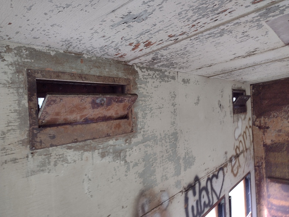

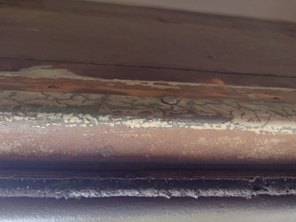

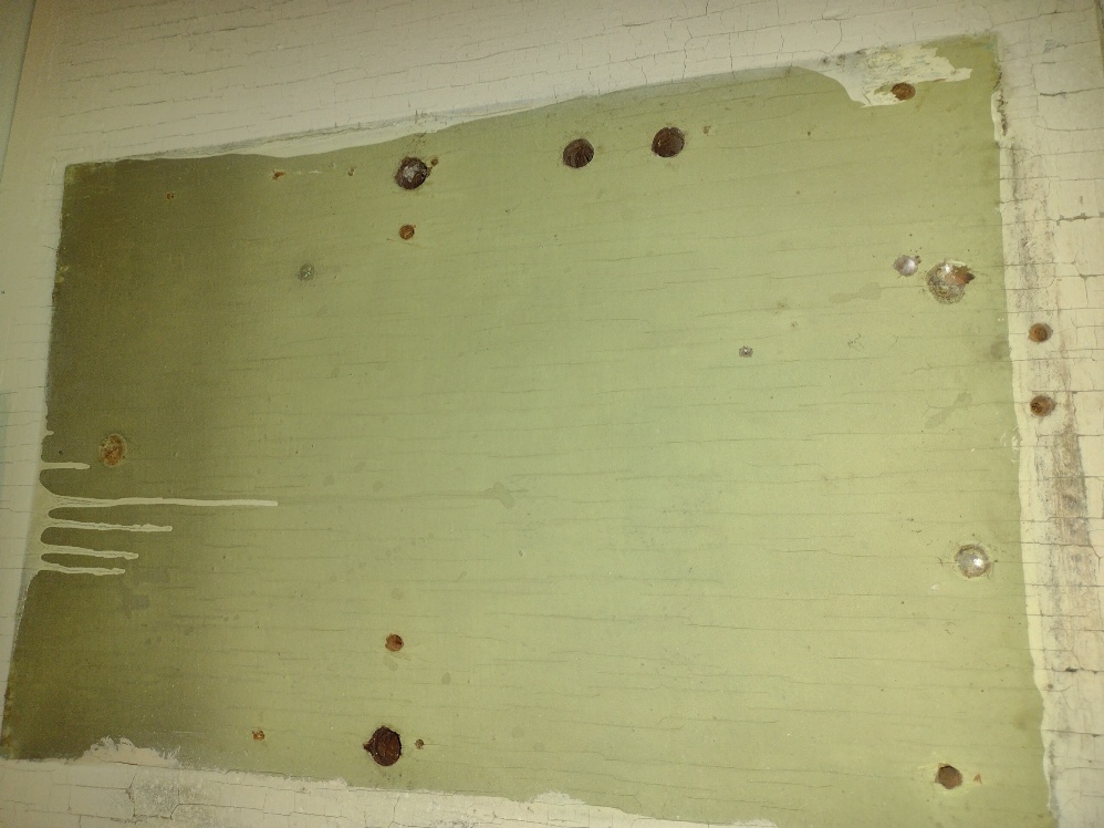

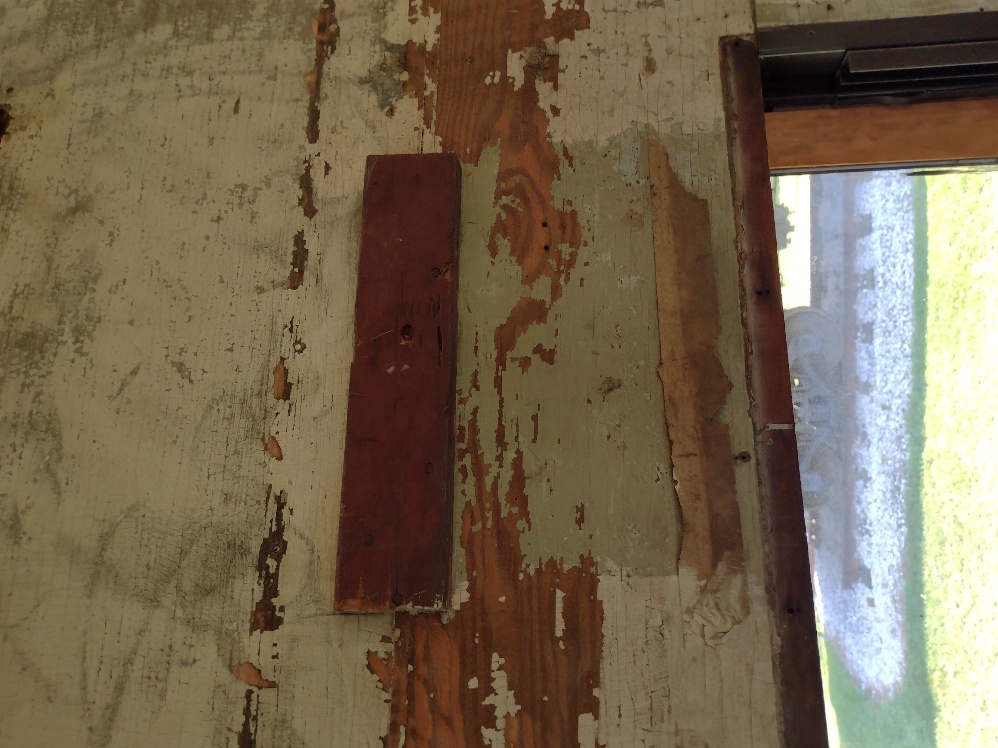

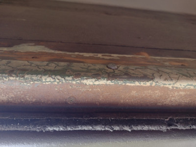

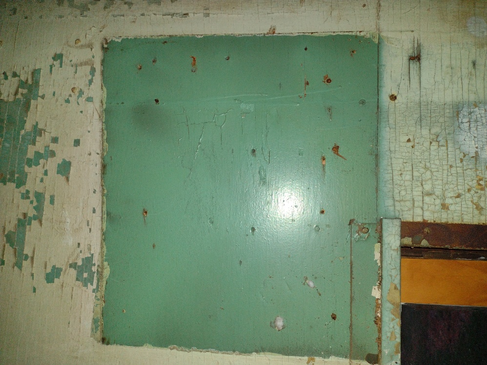

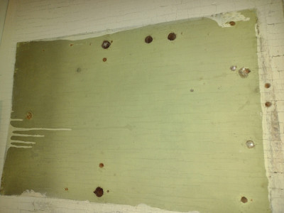

For those following along on the home edition, here's a photo dump of what we are looking at.
I am wondering if the civilian color mentioned was applied over the military government colors.
 Post subject: Re: Pullman troop sleeper interior colors
PostPosted: Tue Jan 09, 2024 10:32 pm
Posts: 2071
I'd be willing to bet that the to shades of green are original to the car as they're not checked or peeling as badly likely due to proper surface prep when built. You can usually get a lot of checking and peeling when you paint over old oil-based paint without proper prep. Even worse if the paints were not compatible.
I like the idea of contacting the B&O museum's restoration department. I don't have a contact there but another RYPNer might.

That paint is breaking up like lacquer.
The fourth picture looks like Lettuce Green and the fifth, Jade Green. I see what could be French Gray there also but I'm not saying anything about those three different ivories except Peach Blossom appears to have a nice pinkish bloom... LOL

This is most likely close to the darker green:
https://color-register.org/color/hospital-green
The lighter green, no clue at this time.
Keep in mind those oil binders would yellow and/or pick up grime thus darkening over time.
