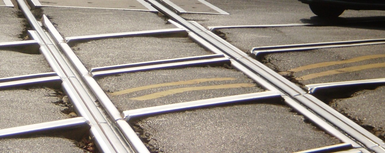

This is not thread creep - it is more like a brisk walk back to the Darby Crossing.
This is an enlargement up of a picture of the dual-gage crossing at Darby taken about four years ago. The B&O runs top to bottom with Philadelphia behind the photographer.
It is not a properly built crossing at all but looks like a jury rig made out of bits of left over rail (That's both the lawyer and the civil engineer speaking). Despite the guard rails there is inadequate flange support for the SEPTA cars and the flanges were striking the CSX running rails instead of just rolling over them. If you look closely the grooves in the running rails from the streetcar wheels are between the size of a quarter and a half-dollar.
Meghan
