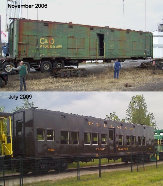

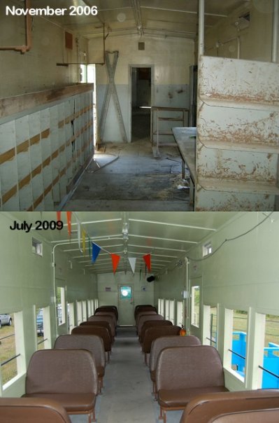

We have a 50' former Troop Sleeper we converted from C&O MOW service to a coach a few years ago. Troop Sleepers were based on a boxcar design.

I believe troop sleepers are considered passenger equipment already. No?
Randy Patterson
RMNE/NAUG

Posts: 773
It WAS a troop sleeper. Since the war it was in MOW service as storage. But I don't really see your point.
