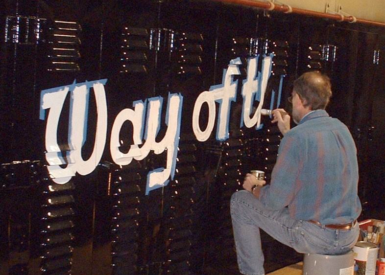

Thought of a well documented project involving most lettering techniques.
Photo of me hand painting IRMs CB&Q SW-7, 9255.
This restoration involved a broad range of stencils, hand painting and vinyl decals. For a slide show of the start to finish process project manager James K posted the photos here.
http://www5.irm.org/gallery/9255painting?page=1
Finished photo here.
http://www5.irm.org/gallery/9255painting/aci
It's been over 10 years but I remember being directed from RYPN to a CBQ chat group, and asked for lettering details. A helpful gentleman there had completed vector artwork of the same loco in HO scale. He generously donated his files for the IRM project. Yes vector files can scale from HO up to full scale without any pixelazation. However I did need to touch up edge details noticeable with that much enlargement.
The side louvers prevented any masking so a full scale print of the side graphics was done on heavy stock for a stencil guide to do the hand painting.
The reporting numbers were painted using vinyl masking. And the heralds are reflective vinyl decals. The paint for the hand painting was the same as the high quality paint used. Whatever it was, it thinned with lacquer thinner, and painting the 2nd coat was difficult as it tended to dissolve the 1st coat if you brushed too much.
I still think 9255 is the best looking restoration we have done.

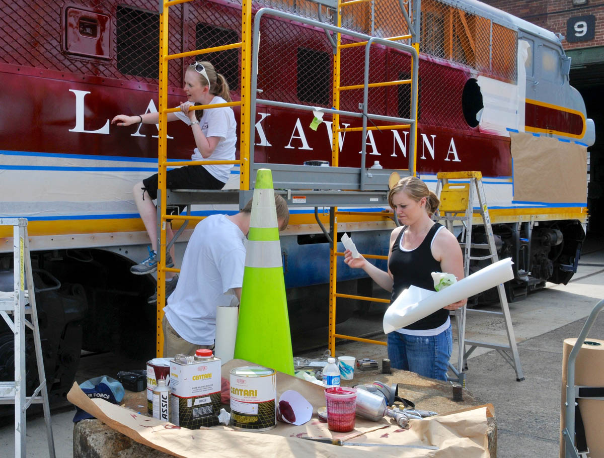

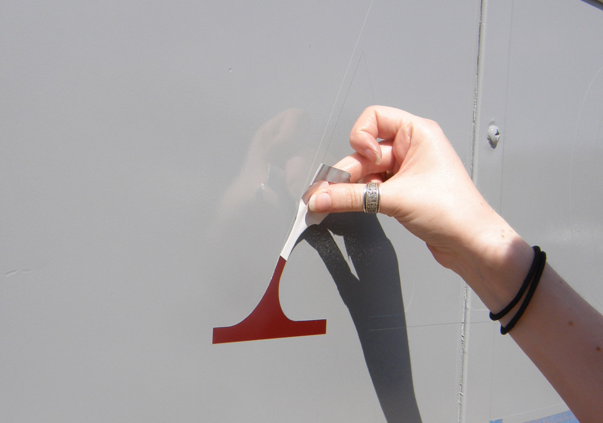

The material I have used is "paint mask" from my local graphics place. Using the vinyl mask is easy, a perfect match for color since paint is used over it, and don't have to worry about bubbles or creases in vinyl lettering. Going over rivets or other irregular surface you need to augment with masking tape. I supply the vector file (Adobe Illustrator) to my graphics shop so I get exactly what I want. The quality of the paint and the proper time to remove the vinyl mask is critical.
