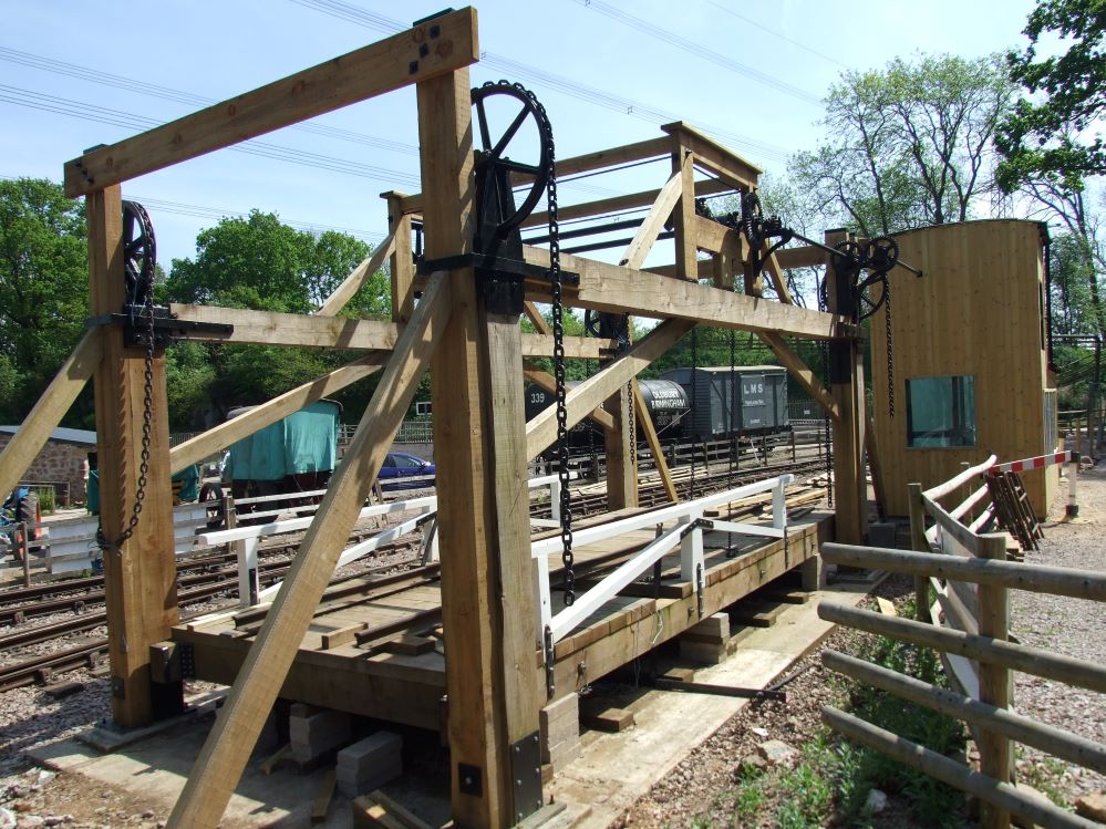

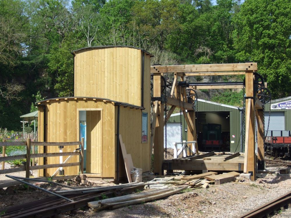

A couple of photos that I took yesterday with the lifting chains now in-situ, albeit with only one of them actually attached to the bridge deck so far......

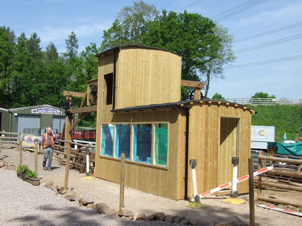

This is a view of the "viewing" side of the operating mechanism/display bulding that has a number of large windows to enable visitors to see inside to view the hand operated lifting gear and various models and other displays relating to the bridge....
There is still a lot to do, but they are hoping to get the project completed by the Fall of this year with an official completion event following either later this year, or, more likely, next Spring (In better weather...)

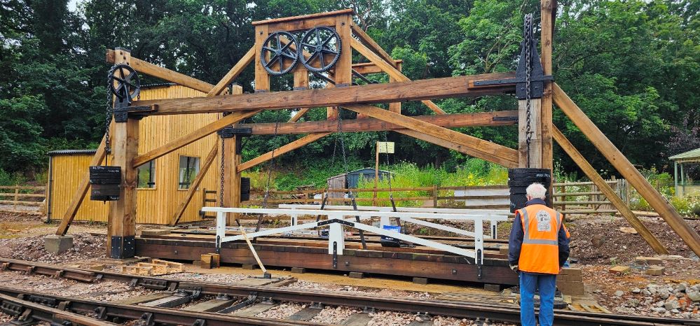

Was sent this image yesterday of the bridge as it was last week....
Basically all the mechanisms, balance weights, etc, are now in place and it's only the actual manual lifting mechanism that needs connecting up to the structure to make it work.
Hopefully I should be able to see it for myself in a months time, by which time everything should be connected up!

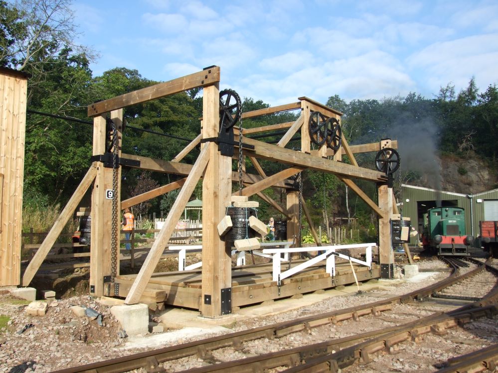

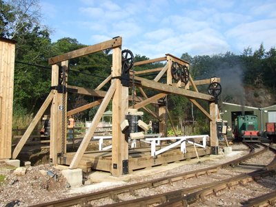

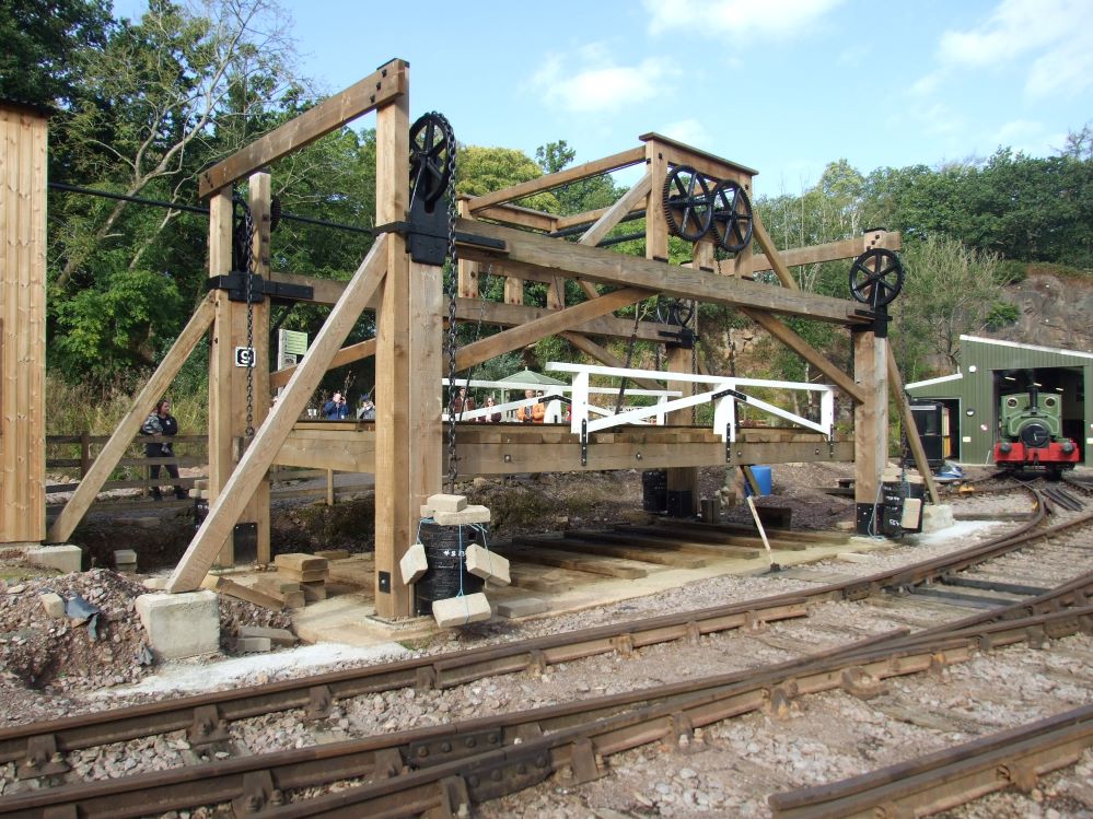

The bridge had its first public experimental lift today.......
Before
After
There is still a lot of adjusting - mainly by trial and error - to get the balance weights right so that it lifts horizontally without tilting at one end or the other as there are no guide rails to hold the thing in place or level. That explains the concrete blocks dangling from the original metal weights and new weights will be cast accordingly once the required loads have been determined.
The bridge was actually only designed to lift by about 4'8" which was sufficient to clear any canal barges passing underneath.

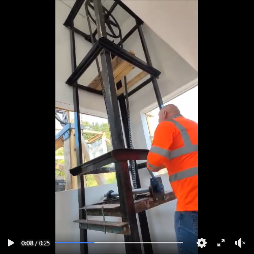

wesp wrote:
Is the lift Armstrong powered? Or is there a motor of some kind?
It has been restored as a manually operated lifting mechanism - a winding handle connected to a horizontal drive shaft by means of a chain - though I believe it may have been driven by an electric motor during the latter stages of its life when at its original location.
The whole thing can be lifted by one person turning the handle with very little effort - hence the reason for the balance counterweights which are set to the approximate weight of the lifting structure itself.
One of the problems is getting an optimum weight set up for the counterbalances as the bridge deck weight will vary depending on whether the wood is dry or wet!
This is a screenshot from a short video on the sites FB page....
Screenshot 2024-10-06 at 06-50-46 Mountsorrel And Rothley Community Heritage Centre Mountsorrel Facebook.png
Screenshot 2024-10-06 at 06-50-46 Mountsorrel And Rothley Community Heritage Centre Mountsorrel Facebook.png [ 261.46 KiB | Viewed 22853 times ]
For the film clip itself, have a look at...
https://www.facebook.com/p/Mountsorrel- ... cale=en_GB
..and scroll down a few posts.
