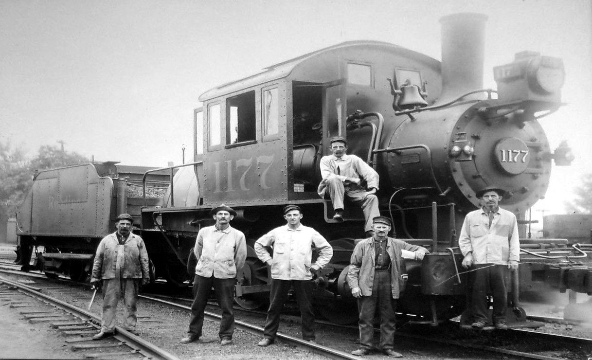

Alright, got a question that involves 1187 here... She's an Class A-4B, but I've seen reference to an A-5A class of 0-4-0 camelback and saw a model of what someone claimed to be an A-5A... Which frankly looked like 1187, but with a steel cab and slopeback tender. Was there really much of a difference between the two classes of engine? Because I can't find any readily available specifications to make a comparison.

Daylight, the A5a's had slightly different valve gear arrangement, mostly around the yoke. Yes, taller steel cabs as well. I own a a live steam Reading A5a, a lot of people do, and the variations from inception to the end of days are innumerable. BTW, these were big switchers,
