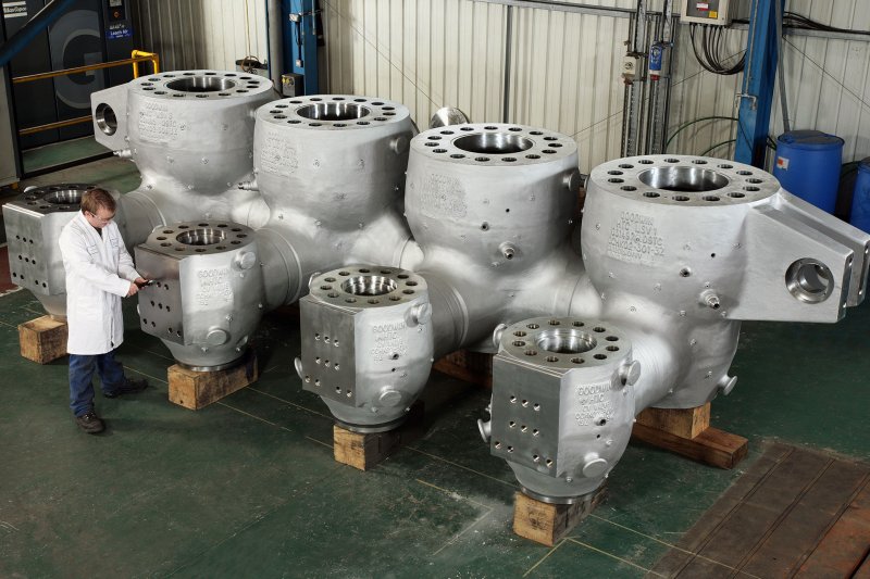

55 ton cast multiple throttle for super-critical power plant. Not quite as intricate as a frame or a loco throttle.
Other examples of current large casting technology:

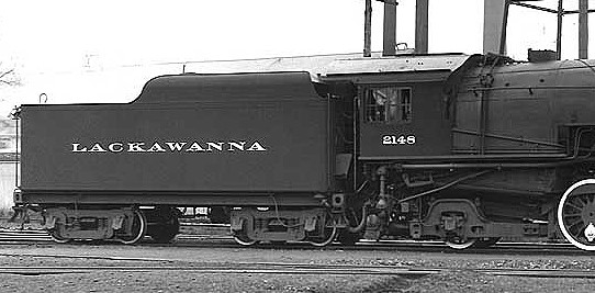

Has any progress been made at cataloging and making available the GSC drawings? I am curious specifically about tender trucks which seem to be an early version of the "AAR Type B" truck used by Alco.
Attached is a photo of what I am looking for specifically, and not sure how these trucks are classified or where overall drawings of them might be found. Thanks for any help.
 Post subject: Re: General Steel Castings Technical Drawings
PostPosted: Wed May 04, 2022 12:56 am
Posts: 215
Location: Bremerton, WA
o anderson, I could be wrong but my gut says that those are likely ALCo trucks under the tender as ALCo built the locomotive although several vendors offered trucks. The drawings would likely be specified whether home built or other source. I don't think GSC did these trucks.
