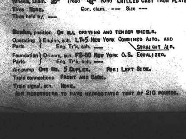

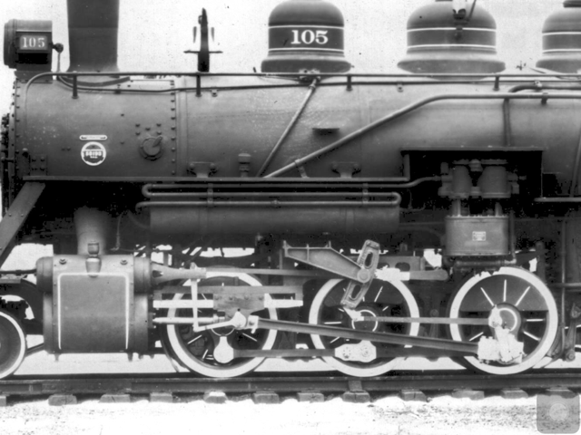

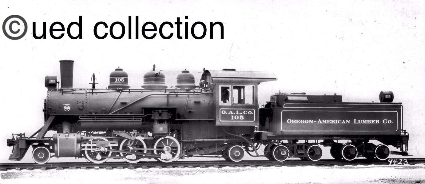

Here an example for a Baldwin with NY air brakes.
2-6-2 Oregon-American Lumber #105
including the info from Baldwin factory ledger.
The third pic show a closeup of the NYAB LT-5 Duplex Compressor.

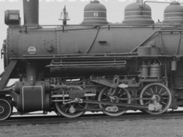

The last pic show Baldwin
2-6-2 City Of Seattle #6 closeup with Westinghouse 8 1/2" Cross Compound Compressor
identical twin with the exception using Westinghouse air brakes.
