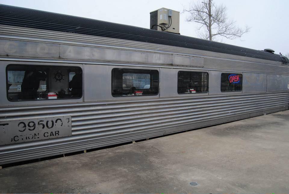

There was an ex-Seaboard Air Line coach that had last been used as a restaurant for sale for $11k in Indiana last year, I have no clue what happened to it, but $250 and able to be moved by rail beats $11k and needs to be trucked, even if SAL is more appropriate for your mission: viewtopic.php?f=2&t=43498&hilit=+sal

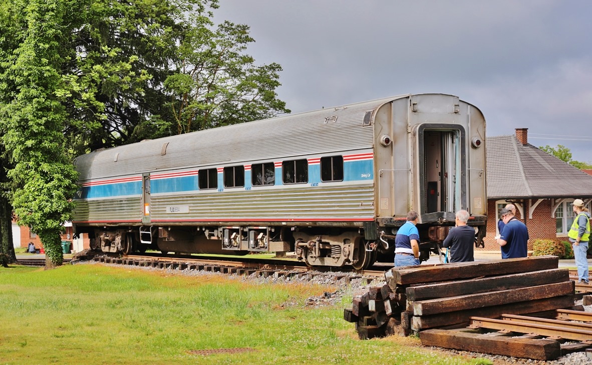

The car in question has arrived, notice the damage above the coupler.

It would be neat if you could come up with replacement skirting for that car, it just looks so "naked" without it. I hope that amtrak band does peel off.
So did they ever admit to what they hit with your car?

A CZ diner would have full-length skirting.
Also the window nearest the kitchen needs unblanked. A CZ diner has six tables and windows on each side. The window in question would be in a banquette with couch-type seats rather than chairs. There are banquettes at each end of the seating area. The banquette windows are slightly smaller than the table-and-chair windows, and the banquettes each have a half-height partition separating them from the table-and-chair seating. In the table-and-chair area, alternate tables have drop leaves to convert them to two seats.

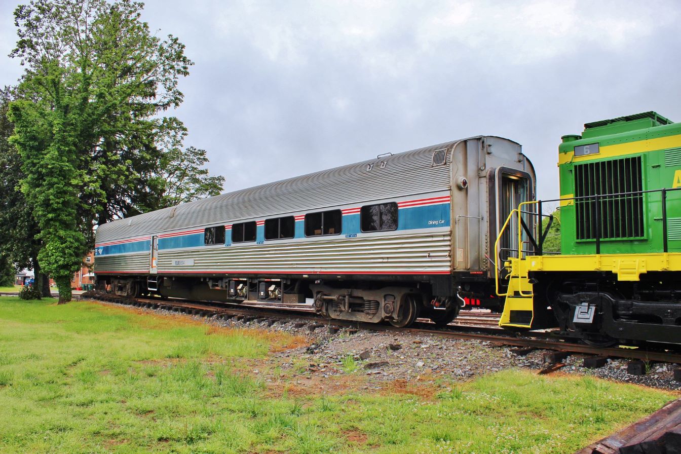

Has the diner been placed on a piece of isolated track? It kind of looks that way in the picture.

No.

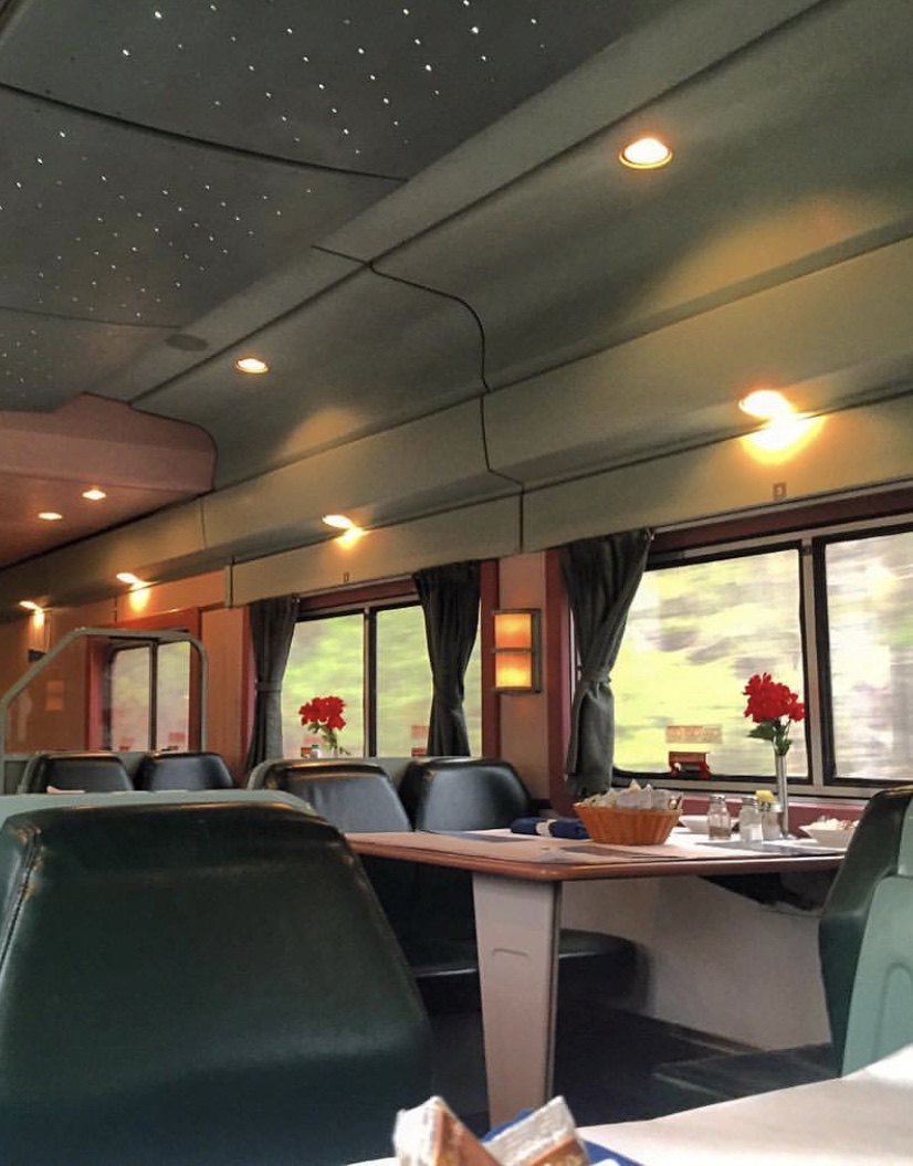

Here’s a photo I took on my last trip in an Amtrak heritage dining car. I was southbound on the crescent. I’ll miss those cars and I’m glad they are being saved as they have great history.

a) Yes, CSX knows they damaged the car and have acknowledged as such. They are waiting on our estimates for damage repair. Basically, they humped a string of these Amtrak cars into a string of tankers with top shelf couplers. Unfortunately, our car took the brunt of the collision.
b) No, the car is not on isolated track. We have a live lead coming in from Norfolk Southern off the old Carolina & North-Western mainline.
