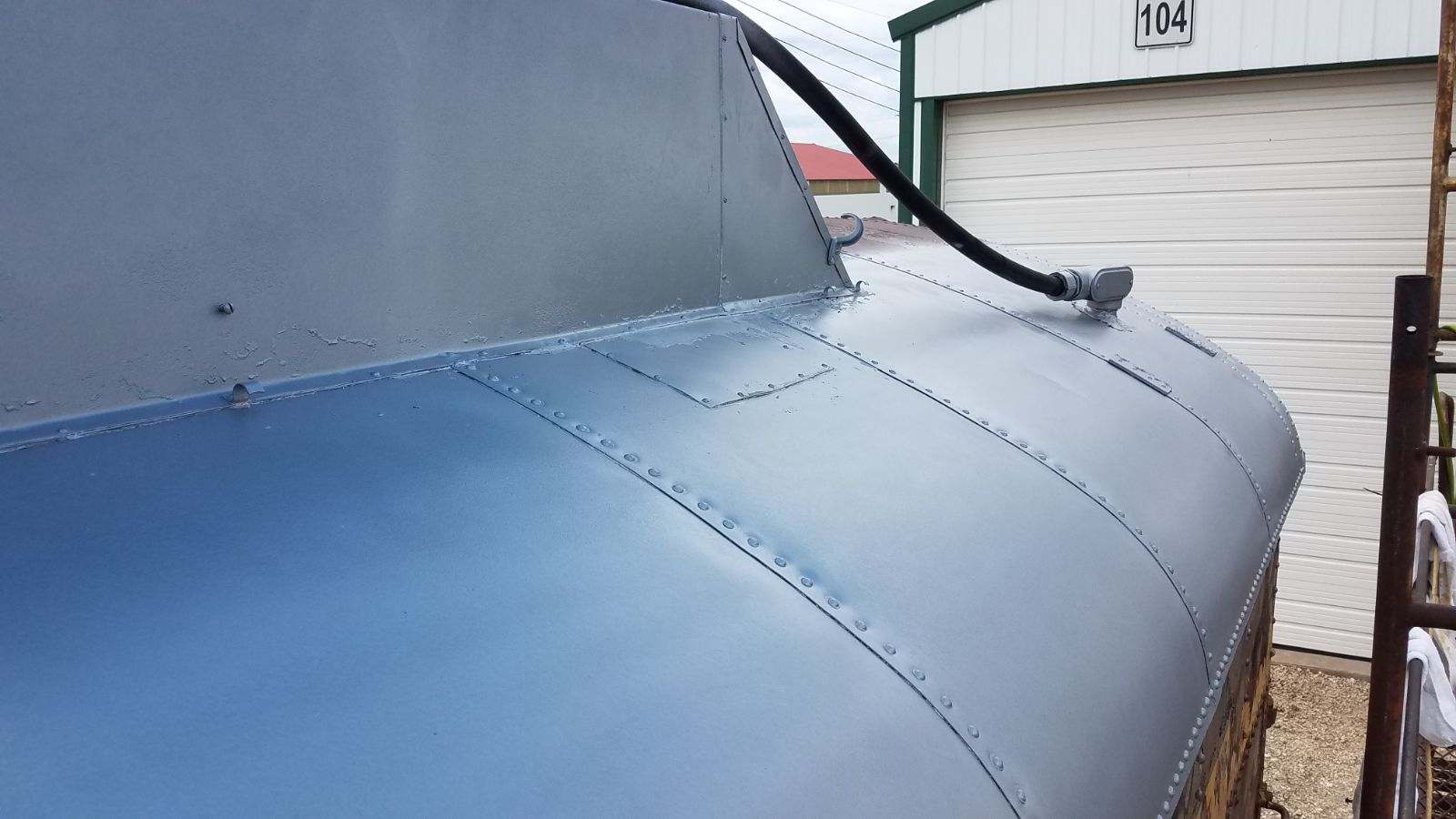

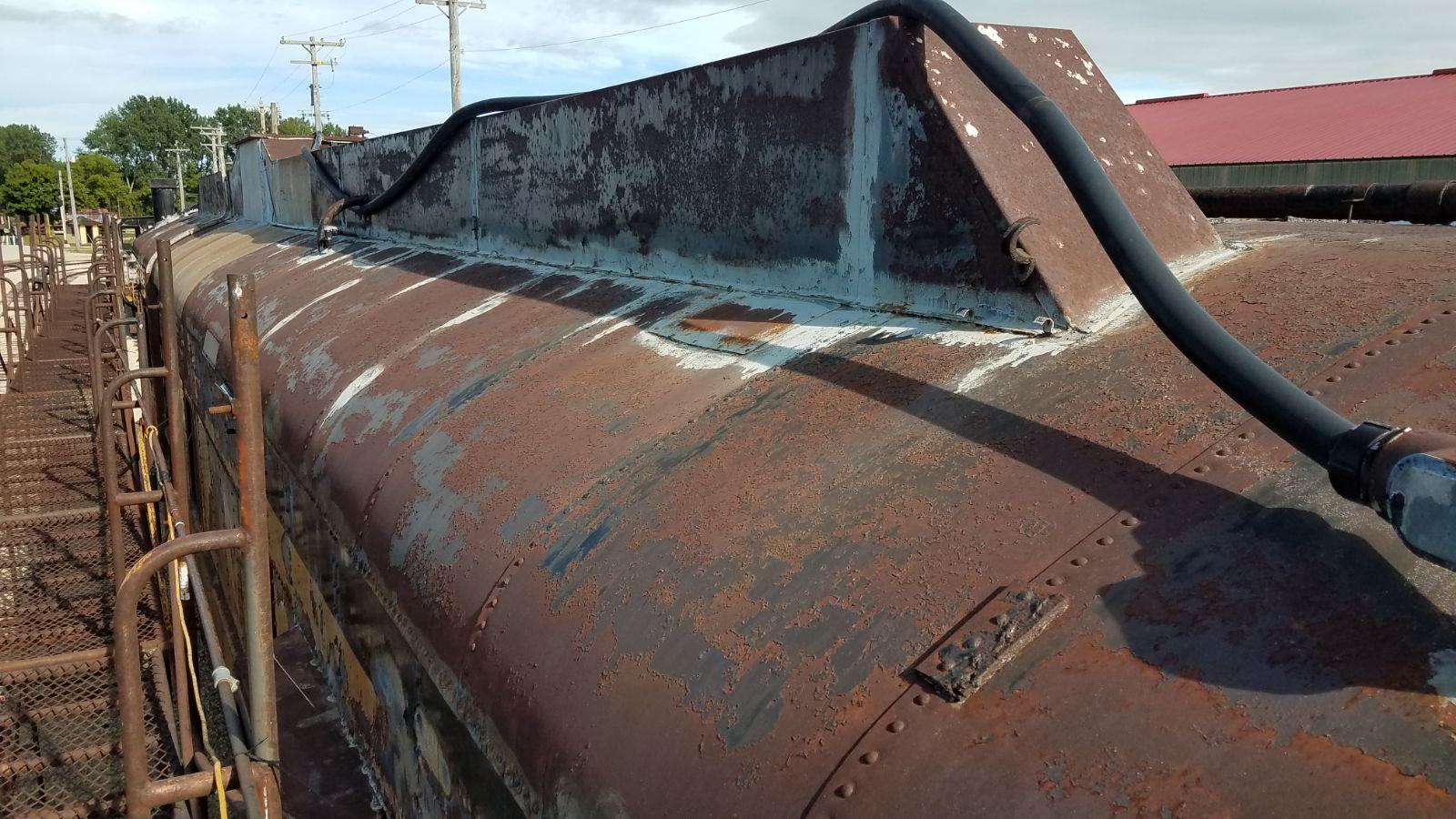

A lot of good advice here. Especially concerning safety and breathing equipment all urethane's contain isocyanate's so fresh air mask should be worn at all times along with other protective equipment.. I worked in industrial coatings for 30 years now and I've also sold New York City subway anti-graffiti paint for 30 years. Fortunately we've never had anyone become ill using these products. I don't know what Imron is going for these days but I imagine it's quite expensive. When doing equipment outdoors the preferred coating system is two coats of the moisture cured aluminum pigmented permanent rust sealer which is surface tolerant in other words it'll seal the rust. The topcoat is a polyester two component finish coat that is an anti-graffiti coating. This system was developed for bridges where sandblasting was prohibited by law due to lead paint hazards. The topcoat AG 111 was specifically designed for the New York City subway system in the late 70s. This system is a documented service life of over 15 years outdoors with less than 5% corrosion. If you would it take two coats of epoxy primer a couple of codes Imron it would do approximately 500 to 1000 hours of salt spray compared to 14,000 hours salt spray with the three coat polyurethane system. The Illinois railroad museum is doing a car like this now.
 Post subject: Re: Painting with Imron
PostPosted: Fri Apr 17, 2020 6:44 pm
Joined: Thu Aug 29, 2019 12:45 pm
Posts: 34
[at
tachment=1]railroad roof.JPG[/attachment] This car was sandblasted prior to priming
