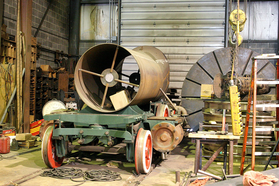

J3a-614 wrote:
Tickling brain cells, I recall seeing the Lyon in the Strasburg shop during the tour years ago, and the boiler was on it. I couldn't tell you what was done, though.
Here's an old photo I was able to dig up from August of 2006:
As for the original plan - I thought, though could be wrong, that the locomotive was to operate at the Boone Scenic - or is that the Boone & Scenic in Boone, Iowa? It certainly places it in Iowa at some point. Not sure it could pull much, even if the line is? relative flat.
Later plans were for a visit under steam at the V&T, though I do not recall any plans for it to become part of the Nevada State Railroad Museum collection at the time.
Did anyone confirm that the project will still be one that sees it operational?
/Mitch
