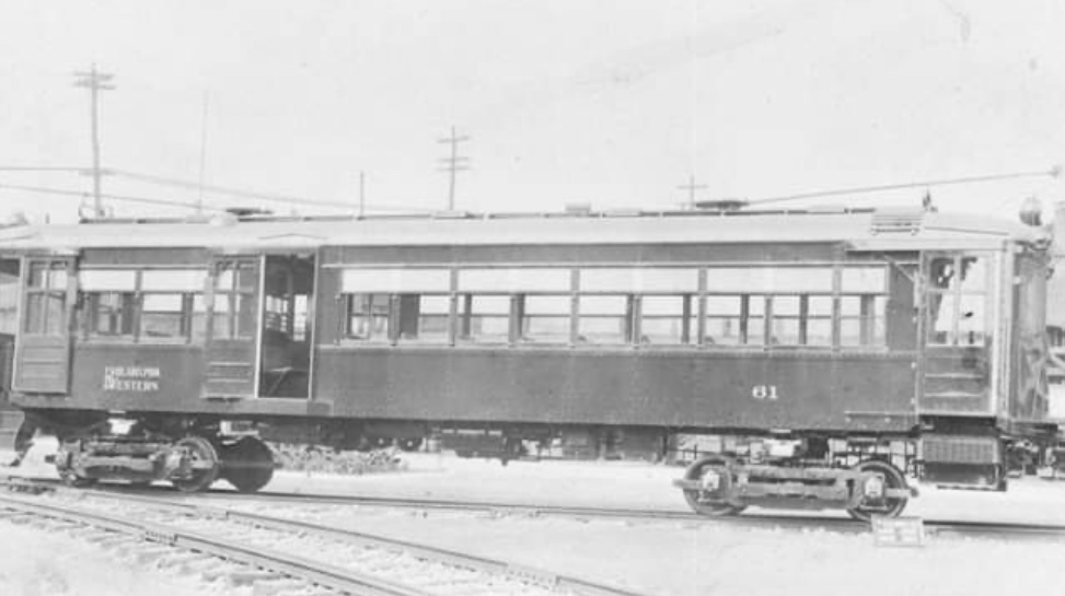

One up, one down.

Interesting. It sure looks like 61 has an auxiliary step on the end away from the center door at the Brill plant. But the other end has three fixed steps that go lower and no auxiliary. Were they testng an idea?
Here's 60 (the prototype) also at the Brill plant:
http://www.ectma.org/erj160.html
Three fixed steps at both ends. 70 (the last car built) has three fixed steps at both ends in its photo too.
It's a puzzlement.

Phil, not to argue the point but how do you know the other step on 61 is fixed? One end has a closed door and retracted step. The other end has an open door and (possibly) deployed step.
 Post subject: Re: Source for Vestibule Steps/Traps?
PostPosted: Fri Feb 28, 2020 10:22 am
Upon further review, the step on the left by the open door does look like the down version of the one on the right. I wonder how it worked.
