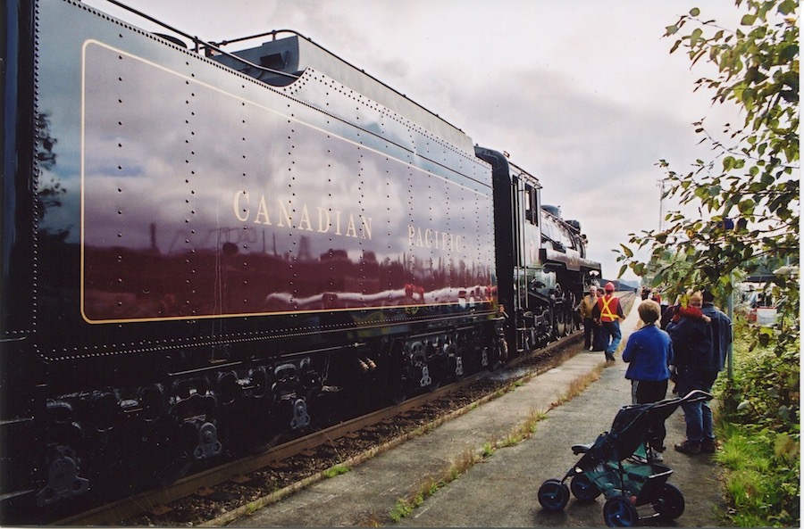

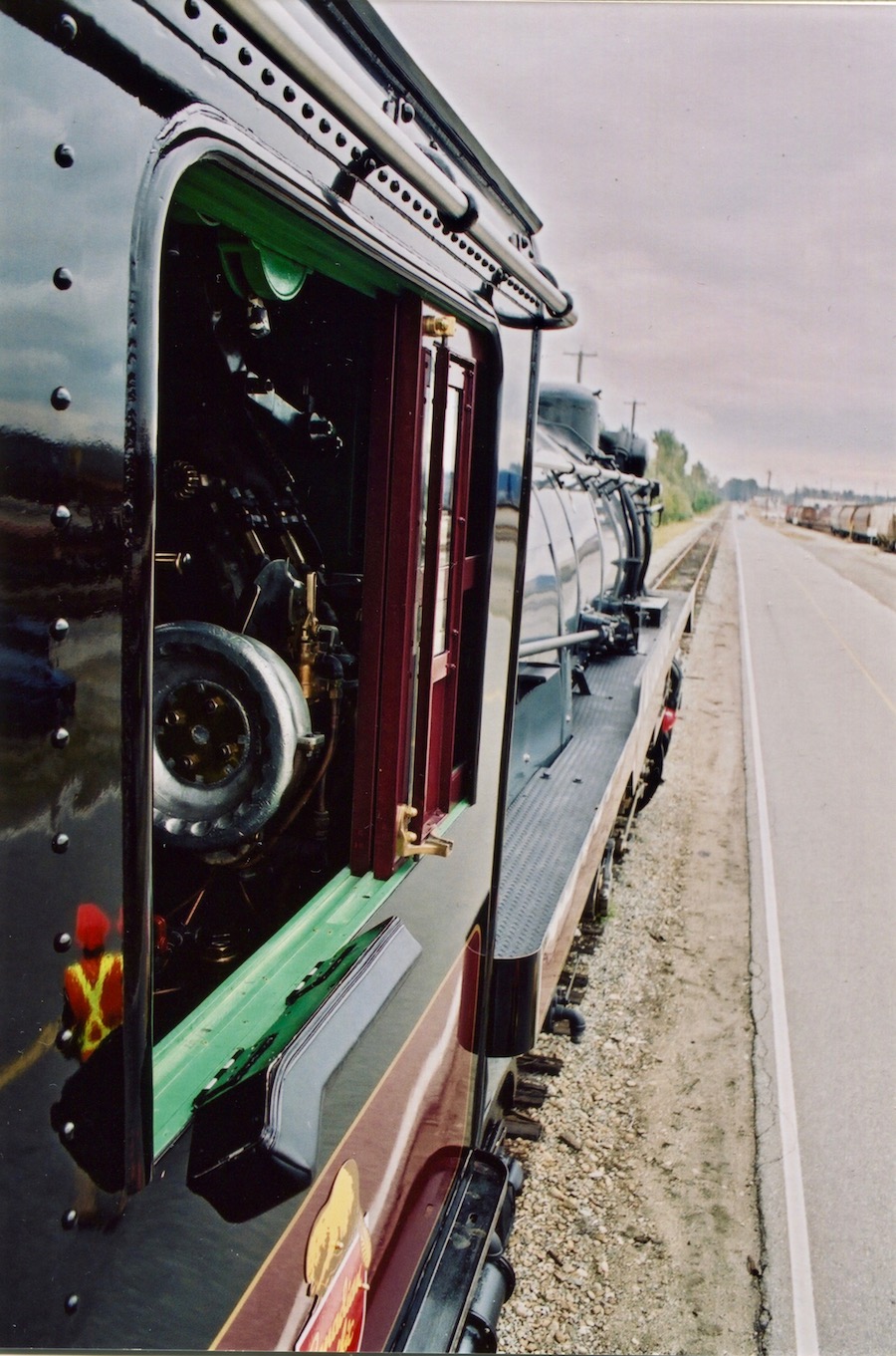

When BC Rail rebuilt the Royal Hudson, 3716, and CP's 2816 Empress,
They used fake rivets in some area's.
I asked the man who did it, how it was done.
The Photo's are 2816, but it was the same for the two other engines.
They used roundhead carriage bolts, and turned down the shank under the head to round. The threaded portion was slightly smaller than the shank, so the threads would not be damaged during installation.
A hole was drilled in the appropriate place, very close in diameter to the shank, so it required a bit of a push to install it. Using a plastic-faced hammer. A nut and washer was then installed on the inside, and tightened right up. That's how the cab rivets were done.
They also did this on the tender, but added a thin gasket under the rivet head, and then installed the rivet. Again a nut on the inside, well torqued down.
The rows of tender rivets also secure the internal surge-baffles in place, so they are not just cosmetic.
This method has certainly stood the test of time, and used ordinary, off-the-shelf bolts.
They had tried the welding method, but found it unsatisfactory for several reasons.

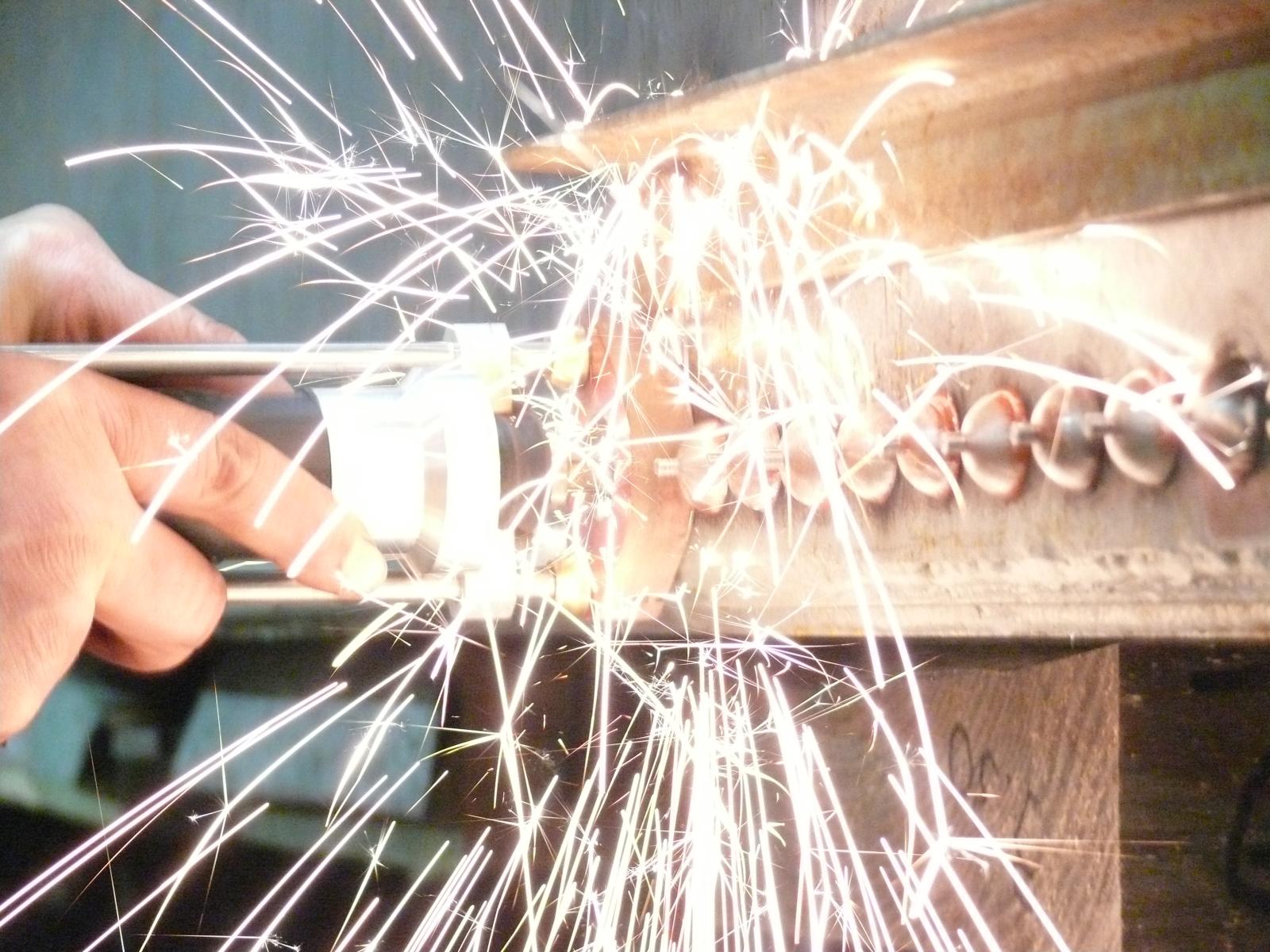

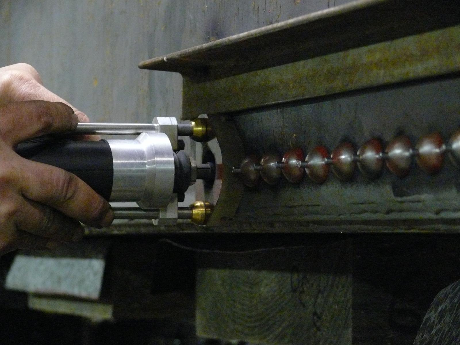

To follow up Russ's comments earlier, yes, Monticello used capacitance discharge welding, used for welding smaller studs to steel surfaces. Strasburg deserves the credit for developing the rivet heads and stud-less application. We bought our first batch of rivets from them. The rivet head has, on the back side, a .005" high stub shank, and in the center of that, a small, say somewhere around 1/32" diameter x a length I don't remember at the moment. (But we found that length is very important.) On the top of the rivet head is a 3/16 nipple about 3/16-1/4" long, which is placed in a collet in the welding gun. This nipple is ground off after the heads are applied. When a rivet is inserted in the gun, the gun and rivet are then pressed firmly against the surface to which it is being welded. The rivet is spring loaded against said surface. When the gun trigger is pulled, the machine discharges a series of capacitors through the rivet to the sheet. The current applied cannot flow through the small pin machined into the stub shank, and the heat generated there creates a molten puddle in the sheet and on the stub shank, and the spring pressure immediately brings the rivet head down onto the molten puddle on the sheet, creating the weld.
On larger diameter rivets, we too had issues with them not bonding well, and discovered the reason was the larger heads had more issues with the capacative energy being lost to arcing at the edge of the rivet head to the sheet, rather than focusing it on the center. This was solved by the very tedious task of placing self-adhesive paper dots over the center pin and stub shank, then spraying a light coating of insulating varnish over the balance of the backside of the rivet head. This stopped the electrical energy leakage, and forced all that energy back to the center, creating secure welds.
The below photos were taken back in 2008, and the only rivet head we have lost since that time was when a scissor lift ran into the tender in the shop, which popped one off. As Russ noted, we stuck a new one one there with a rare earth magnet, and you can't tell where it is, and it is hell to pry it off if you wanted to! All in all, we are satisfied with the look, and we didn't have to drill thousands of holes into something that is supposed to hold water.
File comment: This photo shows a rivet head being applied, with the angle above tack-welded to the tank to provide a reference surface to the top of the gun, and the foot of the gun machined to create the proper rivet-to-rivet pitch.
File comment: Welding in action. This process actually goes really fast once you get set up, and we also found you could dispense with the angle iron guide, simply using a chalk line for the horizontal reference, wiping off the chalk where a rivet was to be placed.

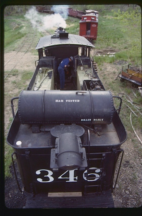

Posts: 172
Kelly Anderson,
A shot of the tender I took in 1990.
Would this have been the original tender..?
Nice work, BTW.
BC Rail used the imitation rivets, as their shop people were not trained in hot rivets, plus they didn't have the necessary equipment, nor the proper rivet tool.
