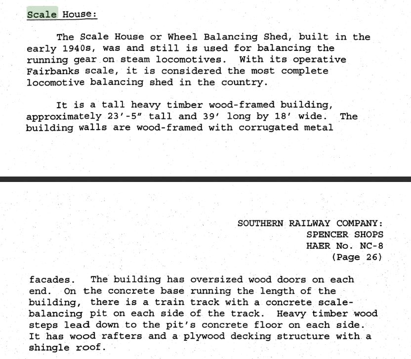

Dave wrote:
Way back in my days at Spencer it was simply know as the "scale house." No idea where the new designation came from
Apparently it comes from the description of the building in the Historic American Buildings Survey of the historic shop complex.
From the PDF version of the text of this report is the following snip-it:
 Post subject: Re: Steam locomotive wheel balancing
PostPosted: Sat Feb 15, 2020 9:06 am
Posts: 2075
Punctuation makes a difference - “scale-balancing pit”. I’d vote for car scale. After modification or repair you have to reweigh the car.
PostPosted: Sat Feb 15, 2020 3:09 pm
But cars can be weighed on a simple single table track scale. What is special about this scale is separate beam balances for each driving wheel, which allows the determination of how wells the equalization is set up. The term "balancing" is, I suppose, appropriate, but confusing because people are assuming that it has something to do with the dynamic balance of rotating wheels.
