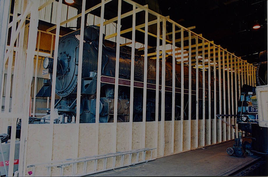

David Dewey,
Regarding the asbestos removal.
I would suggest it's a separate project. A lung-full of those tiny particles slowly kill you.

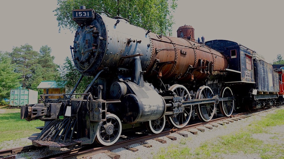

When work started on CNR 1531, the restoration crew removed all the bits and pieces, and safely stowed them away in secure storage. Then an qualified Abatement contractor was hired. Now the rebuild can safely progress.
When CPR's 2816 was overhauled, it required this level of legally-mandated remediation.
The wood frame was covered in poly...filtered air..in and out...5 guys in space suits.
Yes, big dollars, but in todays Green world, if you don't go by the book...the legal implications are enormous.

I'm well aware of "non-conforming fibrous insulating material" removal regulations; but I don't think the current group of locomotive caretakers are. Since this locomotive is very close to the public swimming pool, I have considered the presence of the material to be the greatest threat to the locomotive's continued display. The "solution" so far is to keep the material pretty much encapsulated by keeping the jacketing patched.
The removal offer decades ago would have been done following the guidelines enforced at the time. And would have been done with great care to preserving the locomotive parts. but that was a long time ago and today it would require a pressurized tent and many other measures.
When we removed the SP 1215 from the park in Hanford, we tapped up all the jacket and encapsulated the insulating material. No idea if it was the A word, or the alternative insulating material. The idea then was to get the engine to the museum and inside a building where the cost of removal would be less, being on a concrete floor. That locomotive was de-accessioned before remediation.
