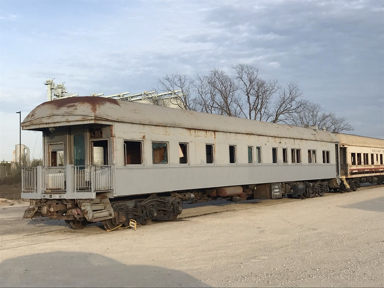

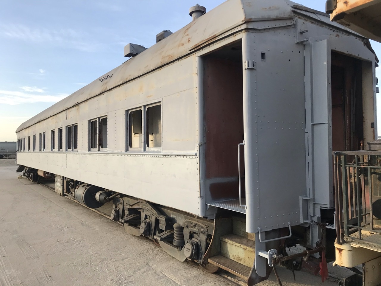

Here are a couple pics of the Dixie as of today (01/28/21).
